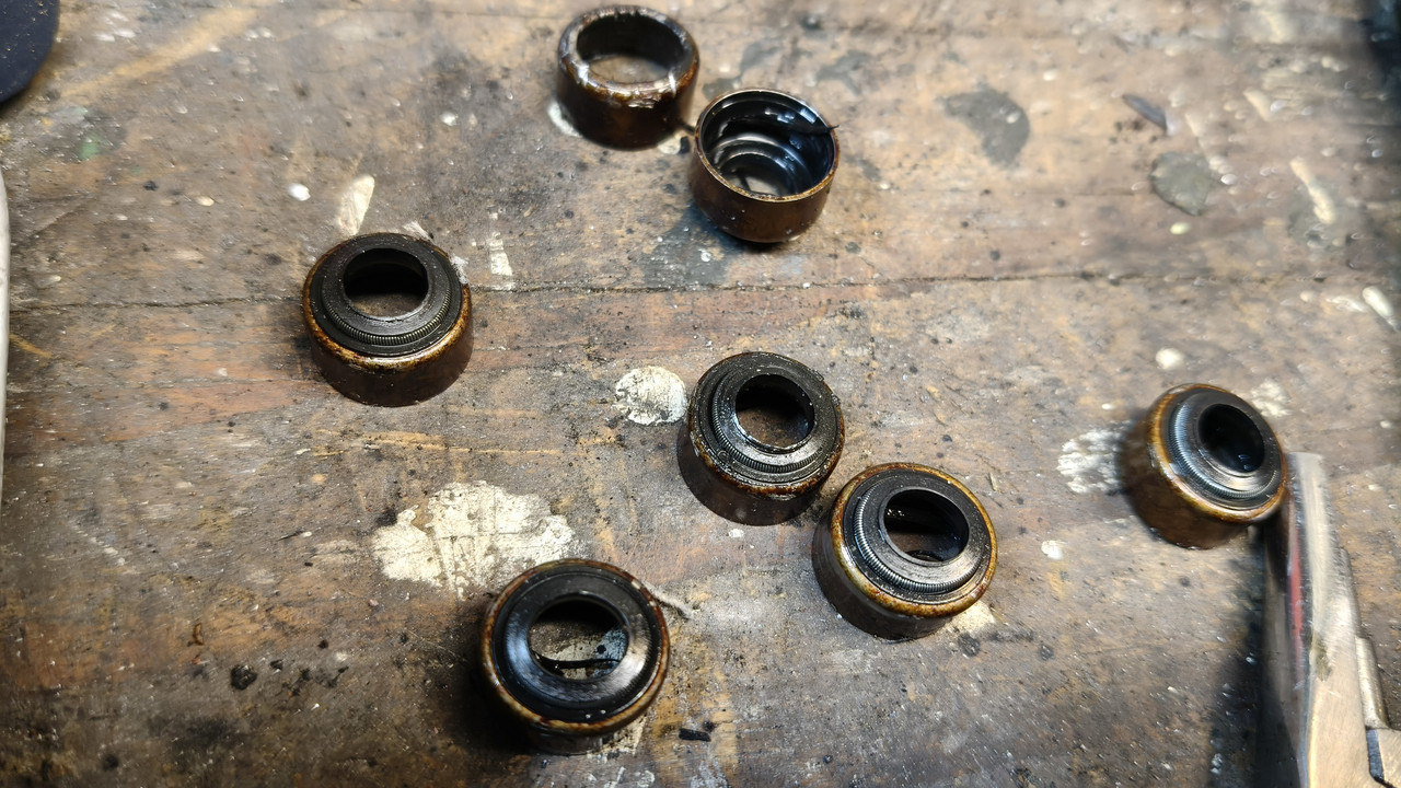

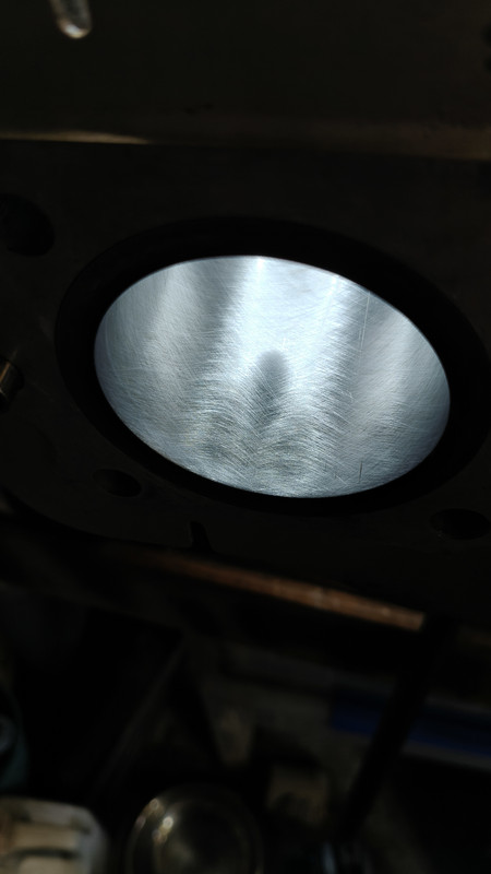

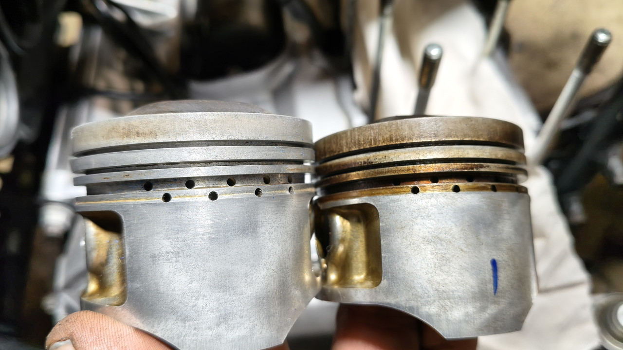

                              My 650G Katana, has been smoking, worse and worse. When I restored it a few years ago, I replaced gaskets and cleaned up the inlet ports, gave it a hone but didn't swap out the rings, or valve stem seals as it didn't smoke before the top end tear down.
                              Compression was good hot or cold, and she made good power, but the smoke got worse, on starting and if you gave her a handful. There was heavy carbon fouling on the plugs. I suspected the oil control rings might be stuck. Tried to use solvent to free the oil rings but this had no effect. The smoke on start up suggested valve seals were buggered too.

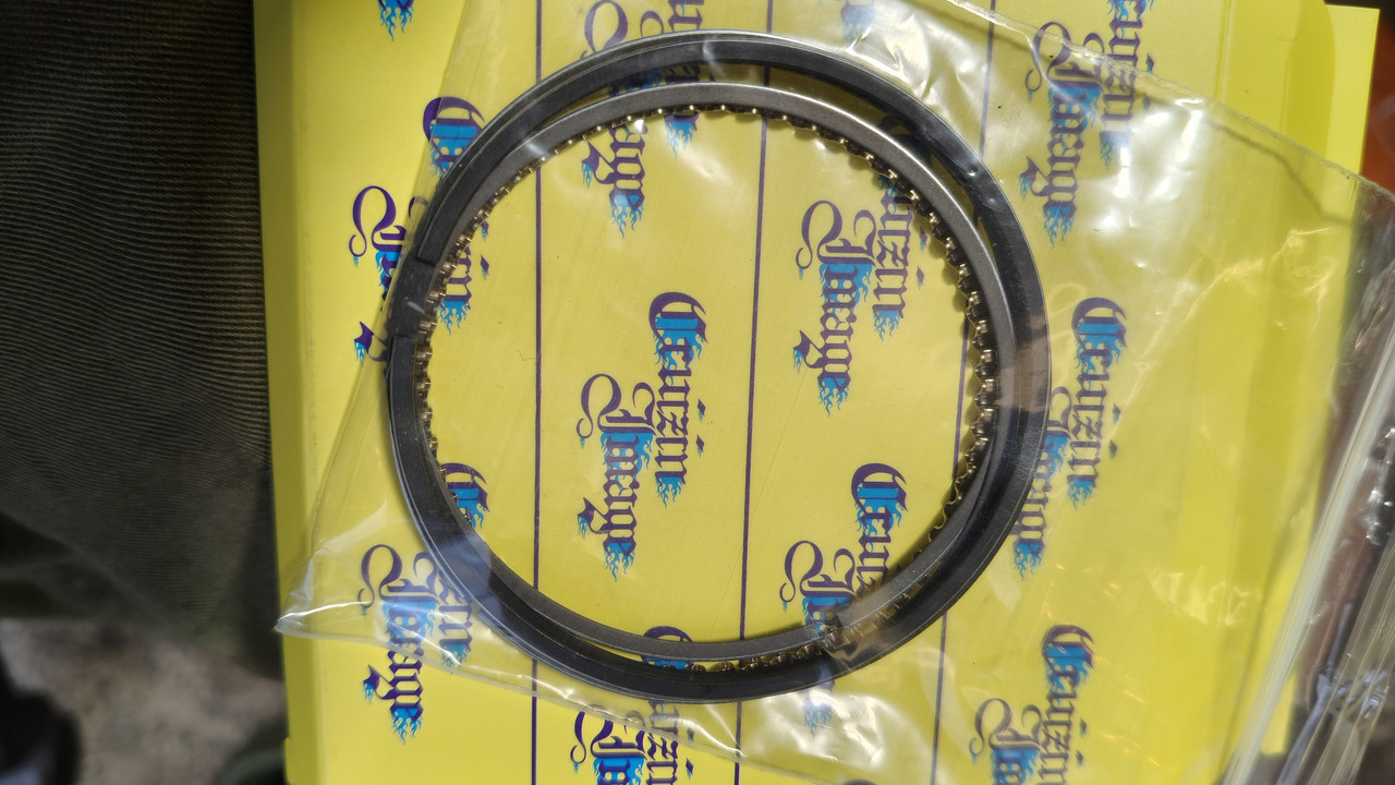

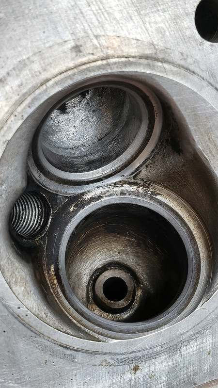

                              I got all the parts I needed, and last week pulled off the head and barrels. My plan, fresh rings and hone, lap the valve seats if they looked iffy, decoke the head and valves.
                              Cleaned the pistons. The ring grooves were full of poo, and the oil control rings were well and truly glued in by oil residue

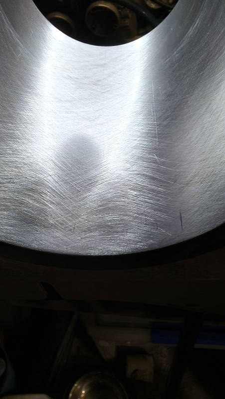

                              Out with the cylinder hone, cut about a 40°cross hatch.
                              Valve seals were like rock. Popped on a fresh set of seals. Fitted the rings. Have used Cruising Image rings before, and they seem to be good quality
                              Wire brushed the crud off the valves. Got the tungsten carbide burrs out and cleaned up the exhaust ports (I had tidied up the Inlet ports last time the engine was open). The inlet seats and valve faces look quite good, but the exhaust seats looked carbon stained. Lapped all the valves in

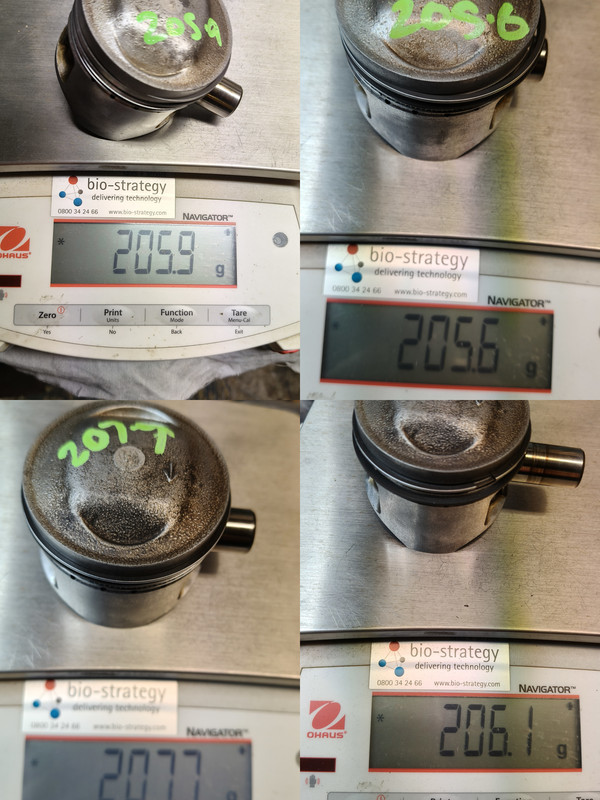

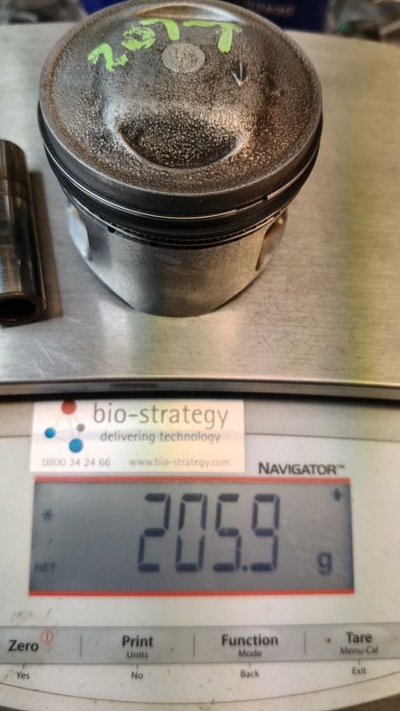

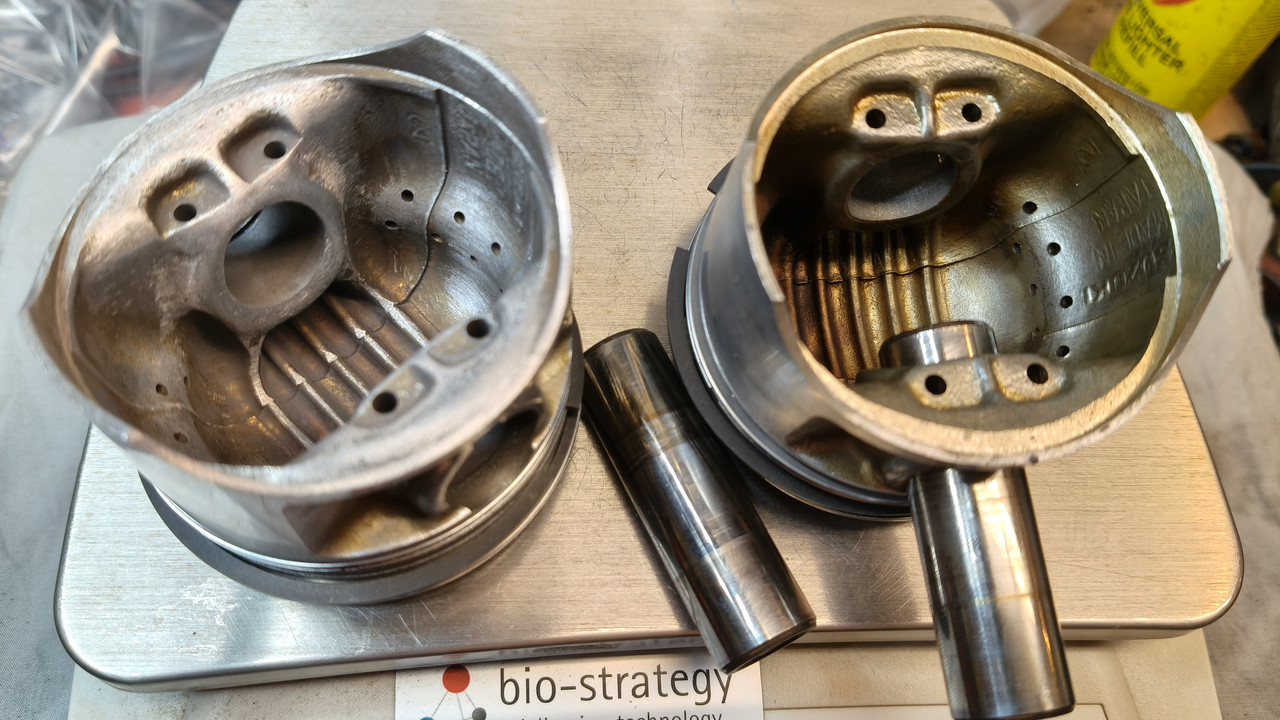

                              Got the scales out and weighed the piston assemblies. 3 of the were in 0.5 of a gram, but I e was close to 2 grams heavier. I relieved metal around the pin bosses, until it was within half a gram.
