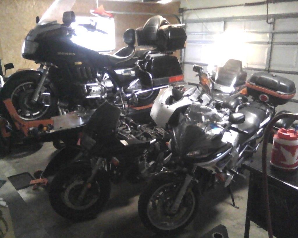

    The only game I watch all year and I forgot it was on. Oh well, atleast I got Kerry's engine together and the valve clearances figured out. The buckets and shims were in a ziplock baggie unlabeled for which valve they came out of. Luckily I mic'd the shims before putting them in, I only had four that were out of spec. Two were too tight, two too loose. A little creative swapping and one of my spares, and everything is either in the middle or at the loose end of the range. It's coming together Kerry.
    I still need to put the carbs, exhaust and new plugs, but now the engines near the finish line and the bike is off my lift.
    I've got a set of B12 carbs too pull and clean and an '85 wing water pump to do today. If I get lucky I'll swap out the clutch basket on my 1100E. Really want to get riding that again. It's going to be another long day off working. What awaits me in the garage.

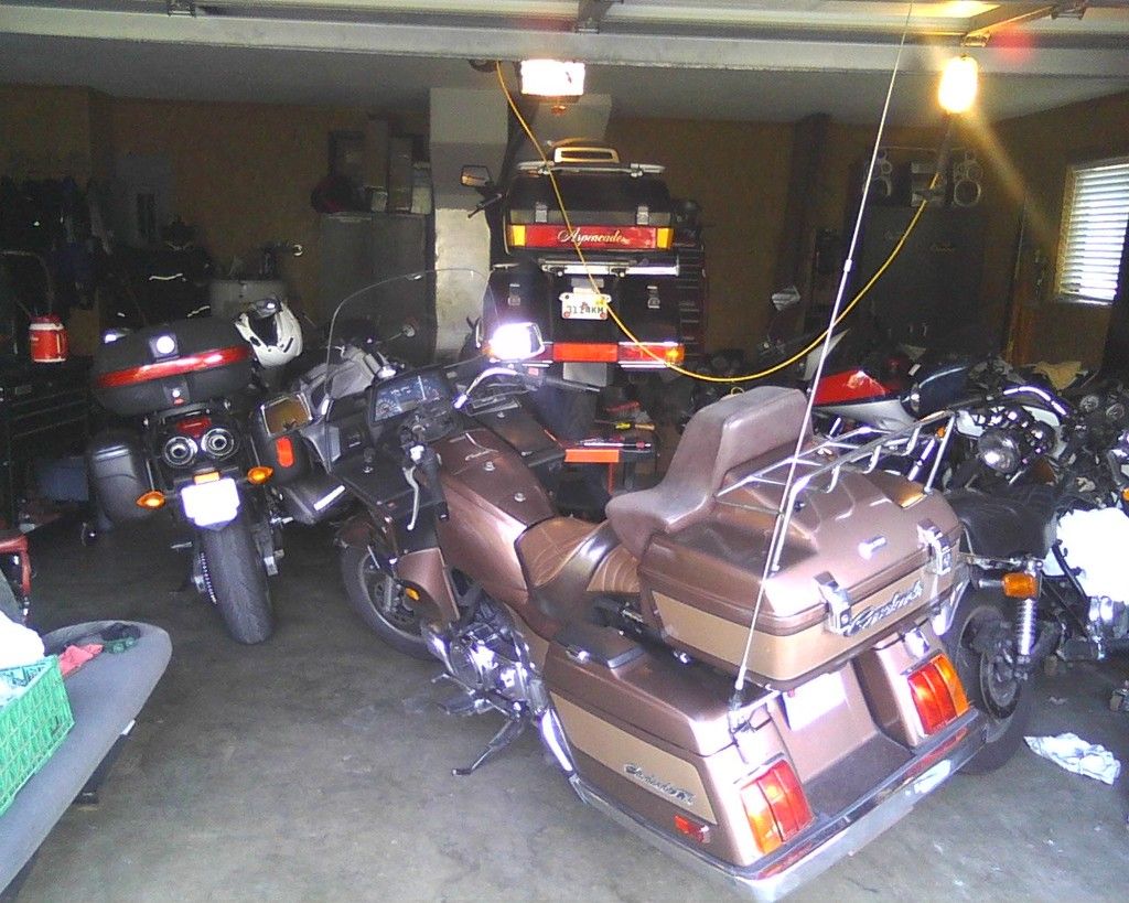

                        I've been taking advantage of this warmer than usual Ohio weather and been working in the garage. I've been working on the new 1000e. I'm updating the ignition system. I have the Dyna coils and Dyna pickup mounted. I had to clean up some wiring. Not to much, I just needed to see what was under the added electrical tape. I don't like electrical problems so I concentrated on doing the job right. I moved on to removing the valve cover. The cover popped off okay but leaving 90% of the gasket stuck to the head. ugh after a hour and a half of scraping, it's clean. Tonight I'll check the valve clearances. Then next will be the charging system... For how clean this motorcycle is, it sure is requiring a lot of work. But hey that's what I do
                          • 4615
                          #5142
                          I had a fun day in the shop yesterday, I got the regulator/rectifier mounted and the wiring figured out. I soldered spade connectors to the stator output wires for a direct connection to the R/R. It's a good thing I'm addressing the charging system on this motorcycle, the old system was literally TOAST. It was destined for failure.
