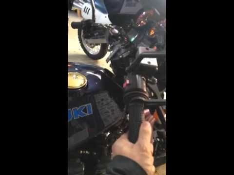

                    Moved the new GS into the very crowded garage today, wanted to find out why the Speedo quit on the way home. This might be it....
                    New cable on the way. Hmmm, maybe I should get a tach cable too.
