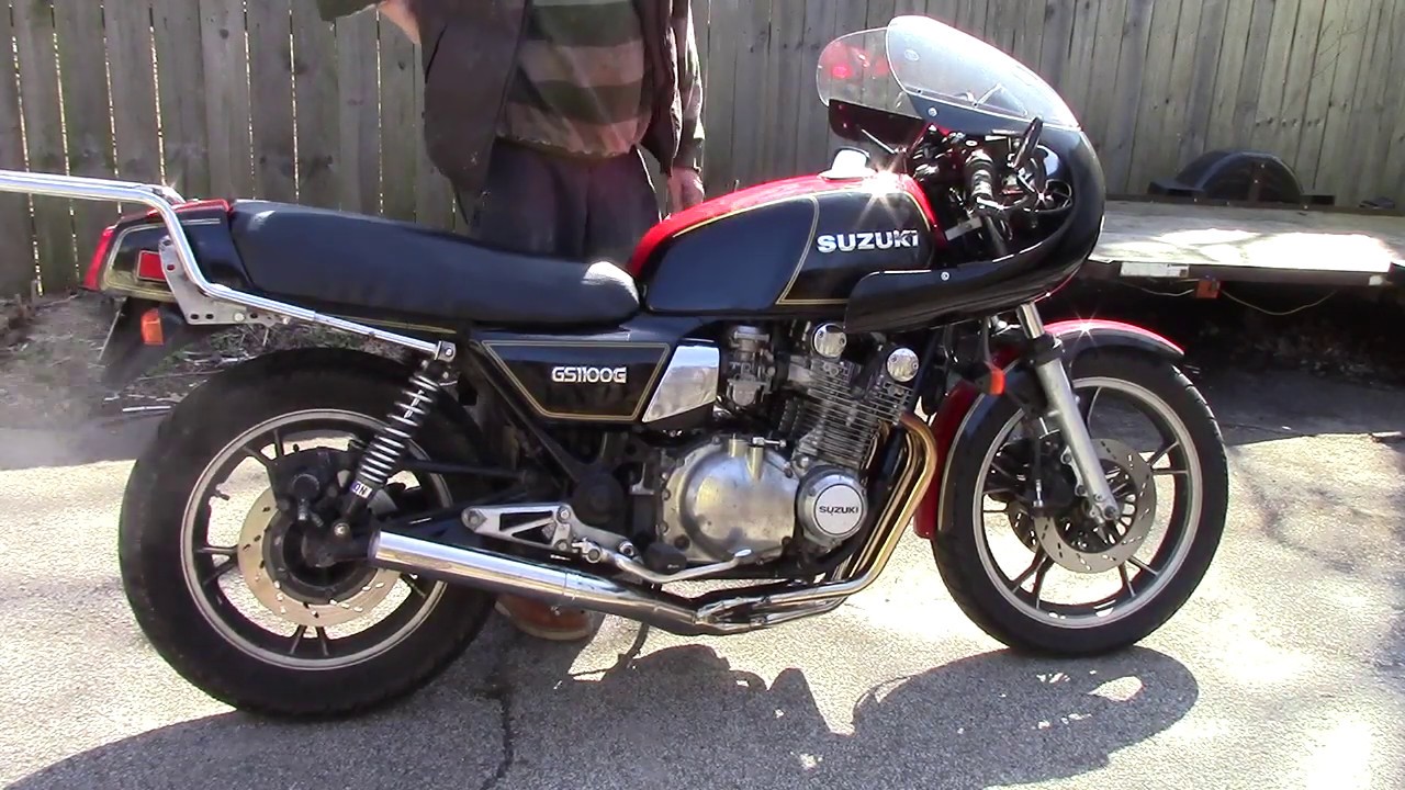

        Bolted the head back on last Sunday, the Delkevic exhaust Thursday.
        Today I'm trying on new luggage.
        good looking bike, nice faring too!

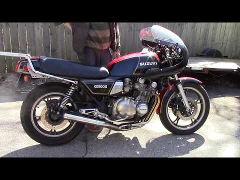

          #7234
          1100G_2020 winter project, running lean
          Ok, it's running and I just did a 12 mile test ride.
          Needs carb tuning, the pipes got color real quick so it's running rather lean.
          I know what to do, I got the tules. Plus I have a set of next larger jets for the top end.
          IMO the Delkevic system is no louder then the OEM dual. However the can is right under your ear while riding, so it seems louder.
          Bummer, the sound kinda reminds me of a truck.
