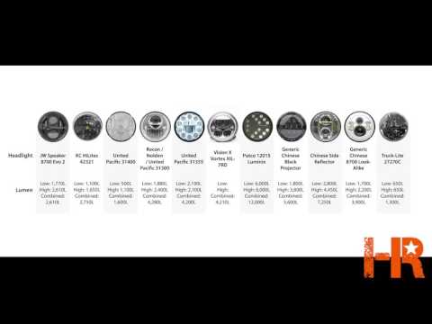

something similar to this....l..e.d headlight.jpgor one of a dozen different types?
Anypne fitted a modern L.E.D headlight on a GS1000?
 Anypne fitted a modern L.E.D headlight on a GS1000?Has anyone tried fitting one of the new range of L.E.D style headlights on a GS100?
 something similar to this....l..e.d headlight.jpgor one of a dozen different types?Tags: None
 Get the Trucklite - I have it on my 550s and Steve has them on his 850s. They are expensive if you buy brand new although Steve found some on EBay for much cheaper that had minor defects. You'll need a bucket that will fit a 7" light and obviously the fork ears may need to be swapped out to fit.Cowboy Up or Quit. - Run Free Lou and Rest in Peace
 Yes, I agree on the Trucklite.
 Yes, they are expen$ive.
 Of course, Chinese knock-offs are available much cheaper, but there are the usual questions about quality and durability.
 However, if you do any riding at night, the co$t is worth it. The light is SO much better. Besides being brighter, the pattern on the road is great.
 Cowboyup mentioned needing a 7" headlight bucket. That is only a concern if you have an "L" or "T" model. If you have an "E" or "G" model, you already have a 7" bucket and the LED 'bulb' is a drop-in fit. Simply "plug and play".
 For those who might have an '80/'81 750E or 1100E with the rectangular headlight, they are available, too. Just a little more co$t, but still worth it. I have one of the rectangular ones in my 850's fairing. My son will have a round one in his Vetter fairing on his 1000G as soon as all the body work gets back from the paint shop. My wife currently has an older-generation Trucklite LED on her 850L, but we have a newer version here, ready to install.
 Besides the co$t, you should also know that it looks a bit "different". If you are trying to preserve the look of a vintage bike down to the last detail, this will not be the light for you, but if you are more concerned with function than appearance, it's the best thing ever.

 Yes, that is the light, and that is the seller where I got the rectangular one for my bike.
 However, you can do better:
 $151.94 https://www.ebay.com/itm/Truck-Lite-...AAAOSwahZay3eO
 $156.00 https://www.ebay.com/itm/Truck-Lite-...YAAOSwehZZ905P
 Free shipping on both.
 When I was shopping for our lights a couple of weeks ago, I got lucky. The cheapest ones I found were for $156, or $312 for the pair. I did a bit more browsing and found a pair for $250, but had the connectors removed. I got a pair of connectors for less than $5 and soldered them in place.
