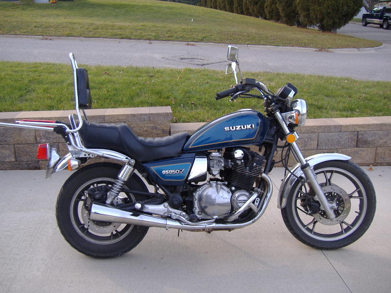

                    Yep, the frames and other bits of the body are different.
                    A chrome rear fender is a big indicator you've got a GL and not a G.
                    Another is little plastic covers screwed to the frame just behind the steering stem; this indicates a GL. On a G, the tank sits a little further forward so there are no covers here.
                    Here are pics of two 1983 models that will give you some more visual indicators of the differences.
                    Here's a 1983 GS850GL:
                    The rack and sissy bar are '80s aftermarket.
                    Here's my 1983 GS850G:
                    Again, rack, floppy trunk bag, and doofy air seat are aftermarket... also, the stock G headlight is black plastic with a chrome ring, and mine is an all chrome replacement. Also, in this photo my G is wearing black plastic aftermarket front turn signals. OEM were chrome like the rear. And it's facing the other direction. And a few other odds and ends are a little different, like missing reflectors up front and missing seat grab bar.
                    The exhausts on the GL and G are a little different as well -- the end of the GL exhaust has six little "pea shooter" tubes surrounding the central hole, and the G has one central hole and is overall a little longer. Hard to see in these side shots.
                    There are several other detail differences, but that should at least enable you to figure out what you have. And of course if you can post a few pics, the GSR Hive Mind will probably be able to instantly ID your bike.
