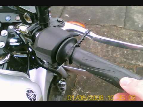

https://www.advdesigns.com/gocrthascrco.htmlAnd on the seventh day,after resting from all that he had done,God went for a ride on his GS!
What like these guys did?Originally posted by KEITH KRAUSE View PostRick, thanks for the reply. Interesting idea. Now you got me thinking and I'll probably come up with my own version and get myself killed.
I had a similar idea today but haven't tried it yet. I have some industrial strength zip-ties that may work. I doubt they'll snug down enough to hold foam, but they may work on rubber grips. Would be as clean and simple as you could get.
