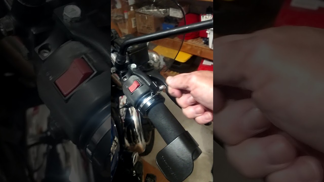

 Any chance you could post a pic here?Originally posted by Wingsconsin View PostI have the Vista cruise on my 850 -
 I also have the foam grip puppies over the typical grips
 The Vista works OVER the FOAM grips quite well - it has many adjustments -
 I have tied a lot of different ones - Right now I have a wide throttle rocker and the Vista lock
 The rocker I only use on the highways to ease the grip pressure needed for a longer ride.
 I don't like the rocker when more precise control is needed so I remove it and hang it on one of my windscreen stays.
 The Vista Lock is like any other throttle lock (except it works) as it locks the throttle in place
 Not a cruise control - it doesn't adjust for up or down hills - so you may find yourself going slow or fast
 BUT - to rest your hand, open a pocket, take a drink, or scratch your nose -- Perfect !
 One other question, please. So the Vista unit goes directly over the grip and the 3 set screws tighten the Vista's "collar" around the grip? Or do the set screws actually go through the grip and contact the throttle tube? Thanks for the help.And on the seventh day,after resting from all that he had done,God went for a ride on his GS!
 I will get a picture tonight when I get home and post it tomorrowOriginally posted by KEITH KRAUSE View PostAny chance you could post a pic here?
 The three screws tighten onto the collar and grab the grip (even the foam) and then it can 'lock' into place.
 A picture is worth 1000 words --
 Even then I did not 'get it' until I had it in my hands and was ready to assemble it onto the bike

 Here's where I keep the Throttle Rocker I use when not on the grip --
 My windscreen has support rods and I slip it onto one of them when not in use
 I do not like it when I am in need of fine throttle control - twistys, heavy traffic , - on the highway it is a useful item

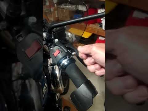

 Here are a few pictures of the Vista Cruise Throttle LOCK in position -
	Forum GuruCharter Member
 Past Site Supporter- Oct 2002
- 8860
- Angeles Forest, So.Calif./Red rocks of Southern Utah.

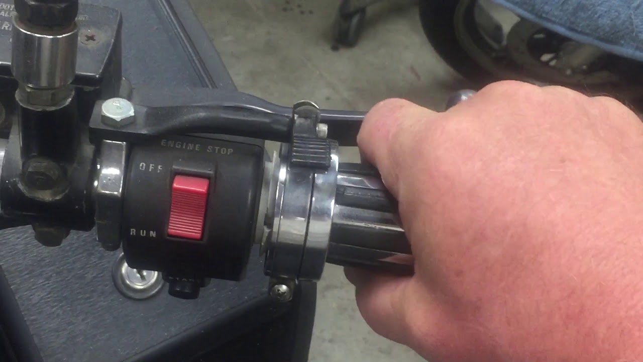

 Wingsconsin, thanks very much for taking the time to help. I do have 3 questions.
 1: What is the total width of the unit that's over the grip? Steve said it was 1/2" but it looks wider to me.
 2: Going by the "friction grooves" on one side of the Vista's thumb lever, it's intended to be mounted so the lever is pointing downward. You mounted yours pointing up, as Steve did. Why did you choose to mount it "up"?
 3: In between your switch housing and the Vista "collar", is that just a rubber ring used to fill the gap or ?
 Thanks again! I appreciate it. And on the seventh day,after resting from all that he had done,God went for a ride on his GS! And on the seventh day,after resting from all that he had done,God went for a ride on his GS!

 Originally posted by KEITH KRAUSE View PostWingsconsin, thanks very much for taking the time to help. I do have 3 questions.
 I would have to place a tape measure on it - I would guess at most 5/8" - It DOES reduce the grip length a tiny bit but not so much it interferes
 I remember having to loosen the brake reservoir to make room for the mount - slide it over a little inside the kill switch assembly
 I do not remember consciously making that choice - it MAY (?) be in the directions that way or I made an intuitive decision based on feel or ..?
 All I know right now for sure is it is really easy to flip 'on' or 'off' - and it works to hold the throttle in the position you are in at the time.
 That is the rubber grip underneath the foam grip puppies I have installed -
 The old grips were too thin for my liking so I added a layer of foam 'sleeves' to the existing grips - Google grip puppies
 The grips have that flared end against the switch housing to cover the throttle tube
 Answering IN RED.
 I will meaure it when I get home, it might be just a bit over 1/2".
 Actually, it is designed to go UP. If it were pointing down, it would be VERY awkward to engage and disengage. Carl's video showed how it works, but it's better when you are sitting on the bike. I use the side of my index finger to bring it down to LOCK position, use my thumb to bump it up to UNLOCK. Very easy, almost intuitive.
 To me, that looks like the flange on the stock grips. The foam is a cylinder that slides over the stock grip.

 Looking closely at Steves pictures and mine I have noticed what I think are differences in installation
 I think this is due to the use of mine over the stock grips AND the grip puppies -
 I installed my 'ring' that grips the throttle tube and grips backwards from how Steve's is done I think ?
 My gripping rubbers are facing outward and his are facing inward -
 You can see the tightening set screws on his are inward while mine are outside--
 I seem to remember doing this as a choice deviating from standard to accommodate my bikes set-up -- ?
 Both work just fine apparently
 As I mentioned (and showed) in posts #4 and #6, it can be mounted in either direction. Most of it depends on the size of the flange on the grip. If it's possible, I will trim down the flange so I can put the ring (with its setscrews) over it, and save the space on the grip. If that doesn't work, I slide the ring as far as possible toward the flange, which puts the setscrews farther than the curve at the base of the flange.

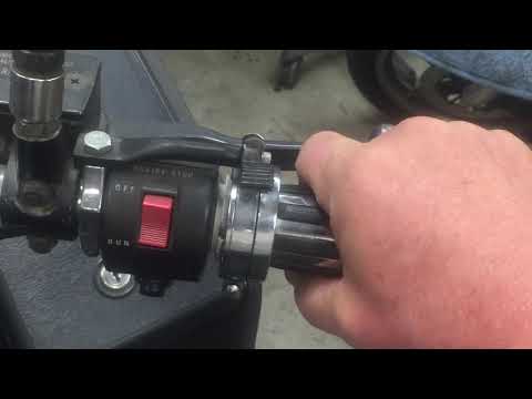

 Steve, when you have time, let me know how wide that assembly is that fits over the grip.
 I visited the Vista website and they show the thumb lever pointing toward the rider, which I'd probably want, easy on and off with your thumb, but I think the crossbar might interfere with pushing the start button on mine. If so, then pointing it upward probably is the best.
 Thanks again for helping me out. And on the seventh day,after resting from all that he had done,God went for a ride on his GS! And on the seventh day,after resting from all that he had done,God went for a ride on his GS!
 As you wish, Keith.
 Evidently I mis-remembered the width of the ring, it's closer to 13/16".
 Also shot a short video of operation. A quick search on YouTube for "Vista throttle lock" shows several videos regarding installation, use and reviews, but this one is for you, and addresses the concerns you have expressed.
