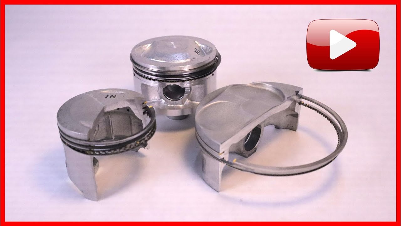

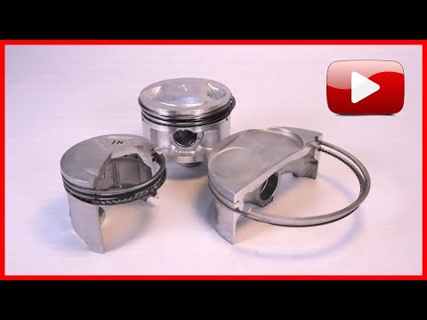

                      Have the day off and hoping to get the new rings on. Replacing rings just because I’m in there anyway, and 38,000 miles. But new rings orientation has me a bit confused and I want to make sure I get this right.
                      Manual has me looking for a noticeable taper on the second ring:
                      original rings, no appreciable taper that I can see:
                      New rings profiles look identical to me. Tops are marked. One is definitely silver/shiny, the other dulll/black. I’m about 73% certain the shiny one goes on top, from the note in the manual about the top ring being chrome plated.
                      no issues with the oil rings, those are straightforward.
                      edit to add- the video below set me straight. The silver in the top/compression ring. The black is the second/scraper ring.
