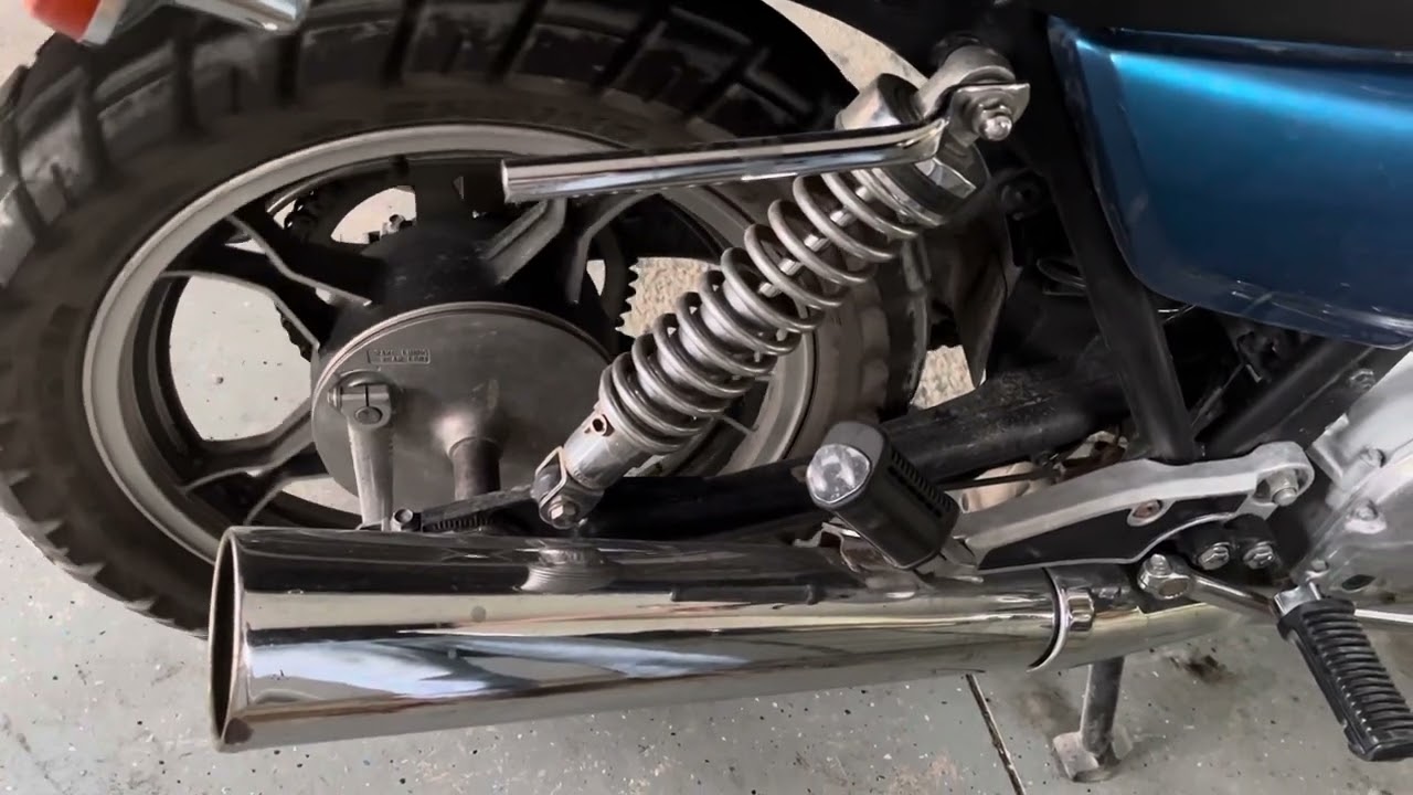

                I just put in 4 new B7EA plugs, went for a 1/2 hour ride. No change. Here’s a video of what she sounds like. After the bike cools down I’ll pull the plugs and post a pic. I think it’s just about beer:30.

                    Sounds like its running on three cylinders. Check the temp of the header pipes.

                      Sounds like it’s running on three cylinders. Check the temp of the header pipes.
                      Agreed. I have no way currently to measure the actual temperature. # 4 is hot, but not as hot as the other 3.

                        Check from a cold start. Very carefully touch the headers right after a cold start. You should be able to quickly figure out if number 4 isn't firing... If it isn't, visually check spark next, with the plug held against the engine.

                          Ed, before installing the new plugs, I did check spark on each against the head. All 4 sparked.
                          After my first cold startup with the fresh new plugs shown in the video above, only running for the 3 minutes of the video, I touched each header pipe at the top bend. # 4 was hot but I could keep my thinly gloved hand on it for a few seconds at least. 1-3 were much hotter in comparison. I could touch them but but only very briefly.

                            Check the carb diaphragm on number 4. I'm having something similar on the 750 Kat and I've discovered some holes in mine. I was doing a WFO main jet plug chop and it suddenly felt like something 'gave' and the performance degraded somewhat, which sounds very much what you describe in your OP. Anyway the story is all here https://www.thegsresources.com/_foru...on-the-kat-750

                              Interesting. Hmm, tomorrow evening I’ll take the lid off # 4 carb and inspect the diaphragm.

                                Rich,
                                I suggest when checking the exhaust header pipe temperatures, do it about 3/4 minute after cold start up, and again after a couple minutes, before the head and cylinders heat up.
                                Oh, and just tap the pipes with back of fingers (skin is thinner on back of fingers, if use finger tips the skin is thicker there and delays your detection and then skin is already heated up oww oww. Old boiler operator guy taught me that decades ago.).
                                That is all I got to help.
                                (I was expecting new plugs to clear up the symptoms.)
