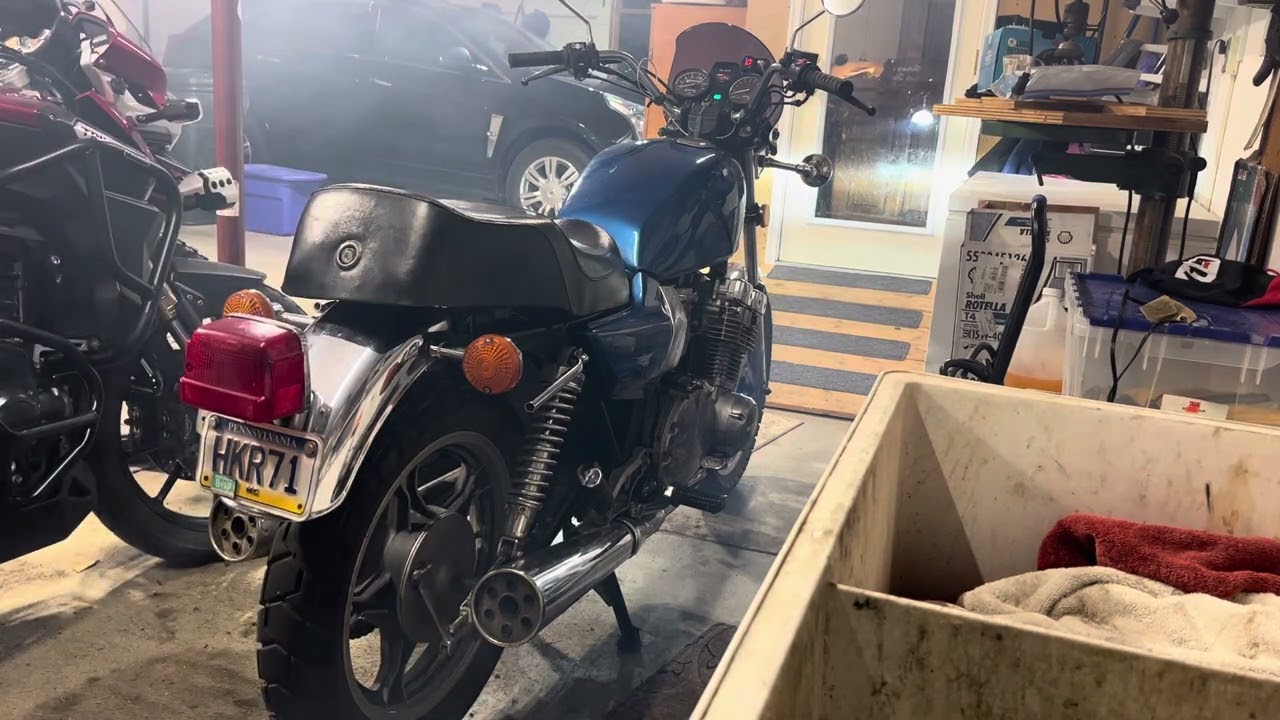

    Worked all day, just wanted to hear it run. Lots of smoke but it cleared up eventually and I got a nice idle. Think I must have pinched a wire putting everything back together. Tail/ brake lights had been working prior to the video. Blew the 10A signals fuse 3 times. I’ll break out the wiring diagram and multimeter tomorrow. Did go for a short ride up and down my lane a few times. Amazing how small this bike feels after riding the Tiger the past few months. Time for beer.

      Remember, open garage door before first start up...Congrats, Proud for ya

        Haha. I had one bay open, and the man door behind the camera. Wasn’t enough. Had to open the other bays.
        I’ll be proud of me too, once I work out the electrical gremlins. Tomorrow is another day.

              Well done! Is there an exhaust leak? Hard to tell from the video sound, but it sort of sounds like that, plus there was some blue spoke out the front of the bike when you first started it.

                I believe I do have an exhaust leak down low at the collector. Will investigate more. First I gotta put all the smoke back in the electrical system that got out last night. The only stuff I have is for positive earth bikes. Hope this works.
