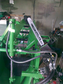

                            • GS1100GK
                              Picture this kind of setup, but substitute GS850 instead of hydraulic drive.
                              Our setup will be a bit different, but there are more pics of this fellow's firewood processor here: http://woodprocessor.blogspot.com/20...-pictures.html
                              The pivot for the saw will likely be a small hydraulic cylinder with a two way foot pedal for control. Sort of like a hydrostatic drive foot pedal. We'll have to manually control the feed of the bar based upon wood hardness and if the saw bogs down at all.
                              We have 2 issues that make a hydraulic drive for the saw troublesome. First, the "right" motor is about $1k. Second, the motor needs about 5k psi to be optimum, but my dozer is only 2500 psi @ 28gpm. Funds for building a dedicated 5k psi 25+ gpm powerplant are...low
                              So it seems possible the GS will become the initial powerplant for the saw. The rest will run from the dozer hydraulics.
                              And, yeah, I almost forgot that we will have to add a cooling fan for the motor
                              I could strip it all down, but there's just something about having a mostly intact bike 6ft off the ground that is sort of cool- in a redneck kind of way!
