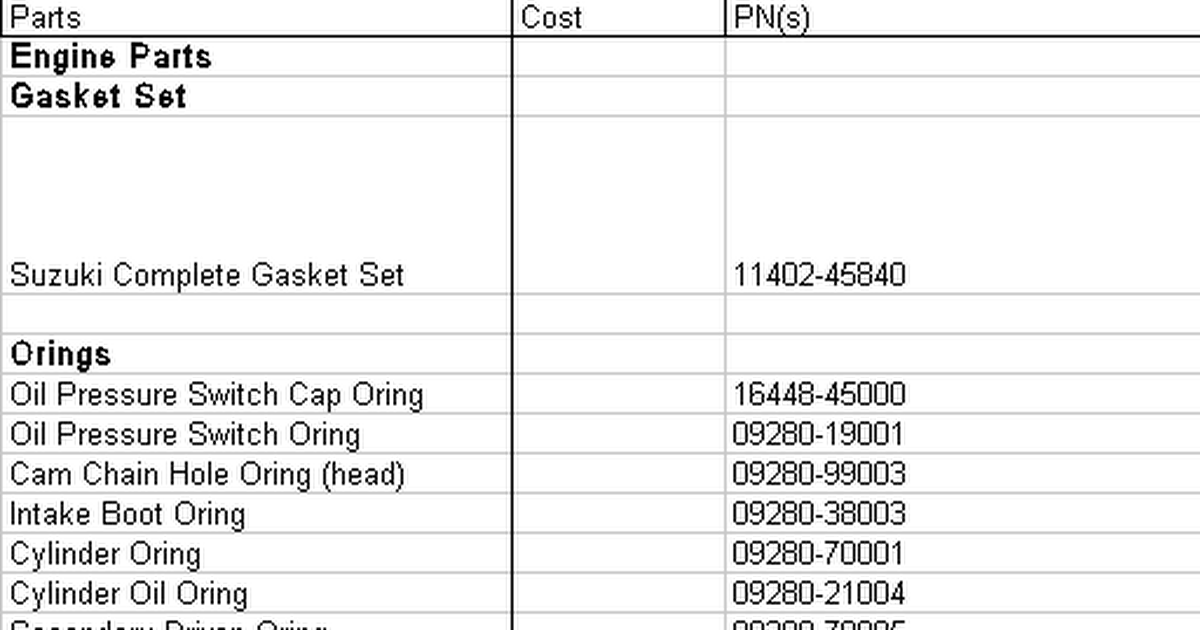

                  I'm trying to build a master list of all needed engine parts. Focusing mainly on gaskets/seals/orings right now. It would be great to buy a complete set and not have to do this though. If anyone sees a missing part let me know!
                  Making a google spreadsheet for each bike:

                          I've split the cases but I am not pulling apart the transmission shafts, I don't see the need to.
                          Okay, awesome. The kit should include what I have boxed in (see the box around detail cell):
                          That means it would not include:
                          Tach Seal Band 26451-45000
                          Tach Oil Seal 09289-05002
                          Crank RH Oil Seal 09283-30021
                          Crank LH Oil Seal 09289-48001
                          Clutch Oil Seal 09285-10003
                          Clutch Lever Oil Seal 09285-12002 same as shifter
                          Driveshaft Oil Seal 09283-35015
                          Shift Lever Oil Seal 09285-12002 same as clutch
                          For the tensioner parts listed here:
                          Cam Chain Tensioner Rebuild
                          09280-06005, 09280-21013, 09284-10006, 12837-45000-H17, 09440-12017
                          oring lock screw, oring cap nut, oil seal, tensioner gasket, spring
                          Do you know which oring is included?

                            On casual inspection, that list looks mostly correct. The kit may also include a few things that I don't think are on the list, like the 6mm sealing washers used in various places (for example, on the bolts holding the small upper rear cam chain guide).
                            The kit does include the copper head bolt sealing washers (four, IIRC), so you won't need to order those separately. It does not include the steel washers, so order new ones if you like things shiny.
                            The kit includes one oil filter o-ring. You can actually re-use these many times -- just replace it every year or two and it'll be fine.
                            I notice carb rebuild kits on your list. In case you didn't know already, do NOT order carb rebuild kits. They're a complete waste of money. Just get an o-ring kit from Robert Barr and clean and re-use everything else.
                            The OEM fuel and vacuum line is great quality stuff, so it's worth ordering some of that if you like. It's spendy, but you get a pretty decent length of it - at least twice as much as you need.
                            Also, the breather tubing (from the top of the engine to the airbox) is an oddball size, so it might be worth ordering that too. It's sort of expensive, though.
                            For the tensioner parts, it's unclear which o-ring you might get in the gasket kit -- only the small o-ring, 09280-06005, is on the parts list under the diagram, but the diagram clearly shows the large o-ring, 09280-21013. Personally, I'd just order both separately -- to me, three or four bucks and the potential for duplication is well worth avoiding the potential for serious aggravation later.

                              Thanks for the confirmation and all the tips! I will pick up oring kits from Robert Barr. I will just order the tensioner parts separately so that I make sure I get them all.
