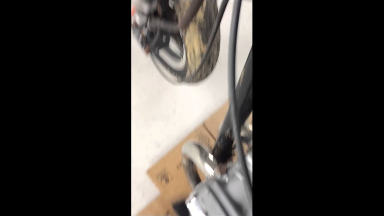

    Hey gang, been lurking a while, finally making a post. I've got a 750l with a terrible knock. The guy I bought it from said it just started out of nowhere on a ride one night. When he bought it, the carbs had been boogered up by someone, so he replaced them and "tuned" them himself... He didn't replace (or install for that matter) the o-rings on the intake ports, cut the mufflers off, and opted for pod filters... How much we wanna bet those carbs still have stock jetting? I haven't looked into it yet, but these things make me wonder if it got ran lean. I got it started to hear the noise, and boy is it rough. Very hash metallic, a bit like a ball peen hammer hitting an anvil and bouncing. I pulled the valve cover off just to see if there was anything obvious like a loose and possibly jumped chain, bent/broken valve, spring, whatever, but no luck. The whole engine is out the frame now, but before I pull the head and totally disassemble, you think I should bother with compression/leak down or will a noise this bad be well noticeable? I'll try to post a video of one of the sadest sounds you'll hear this year. Also, if you respond, add your favorite place to buy engine parts for these old girls. Thanks for any thoughts, ideas, and inputs.

      That engine is noted for pour oiling to the top end , but that sounds more like a bottom end knock to me. I would turn it upside down and split the cases . My guess crank is had.
        • 4612
        Wow! Something is in there and it wants out! My gess is piston to valve or piston to something. Good luck

          I would pull the valve cover first - it might be something in the top end flapping around.

            The 80-82, 16 valve 750s are NOTORIOUS for spinning rod bearings. I used to road race them & tried everything to make them live. I build race engines & THAT engine was just a bad design. You need to split the cases & my guess is the #3 rod bearing is spun.

              in my experience with 80-82 750's.....
              the sound is the piston hitting the head...look for carbon removed on which ever cylinder/combustion chamber and you'll find the bad rod.
              this is the worse one i have heard...most came to me needing a "valve adjustment"
