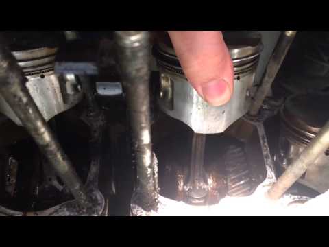

                  Finally got a chance to pull it down a bit, looks like the No.2 cyl lost the rod bearing. I haven't gotten as far as to split the crankcase to remove the rod cap, but there is soooo much play. I don't think its possible the crank can be salvaged. You can see though that the piston was making contact with the head, and while I don't think it bent any valves, it peened the top of the piston and bottom of the head pretty bad. You can actually feel a slight depth on the head. Think the head is shot too? That should change compression on that cylinder... Looking for crank, rods and Pistons for sure. Hope not cylinder head.

                      image.jpg Figured it out I think.

                          Yep, bad rod bearing, the piston is hitting the head. Was it #3 or #2?

                            Never mind, I see it was #2. Now you have to see if it killed the crank journal. You may find it a better end result to just install a 16 valve 1100 or 1150 motor. Those engines are pretty bullet proof & only need a couple of things done to them to make them near indestructible. The bigger 16 valve engines bolt right in too!
