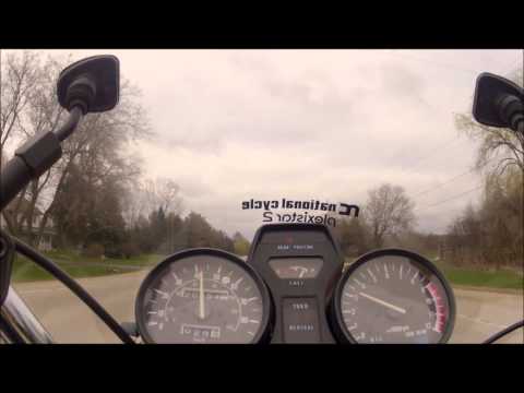

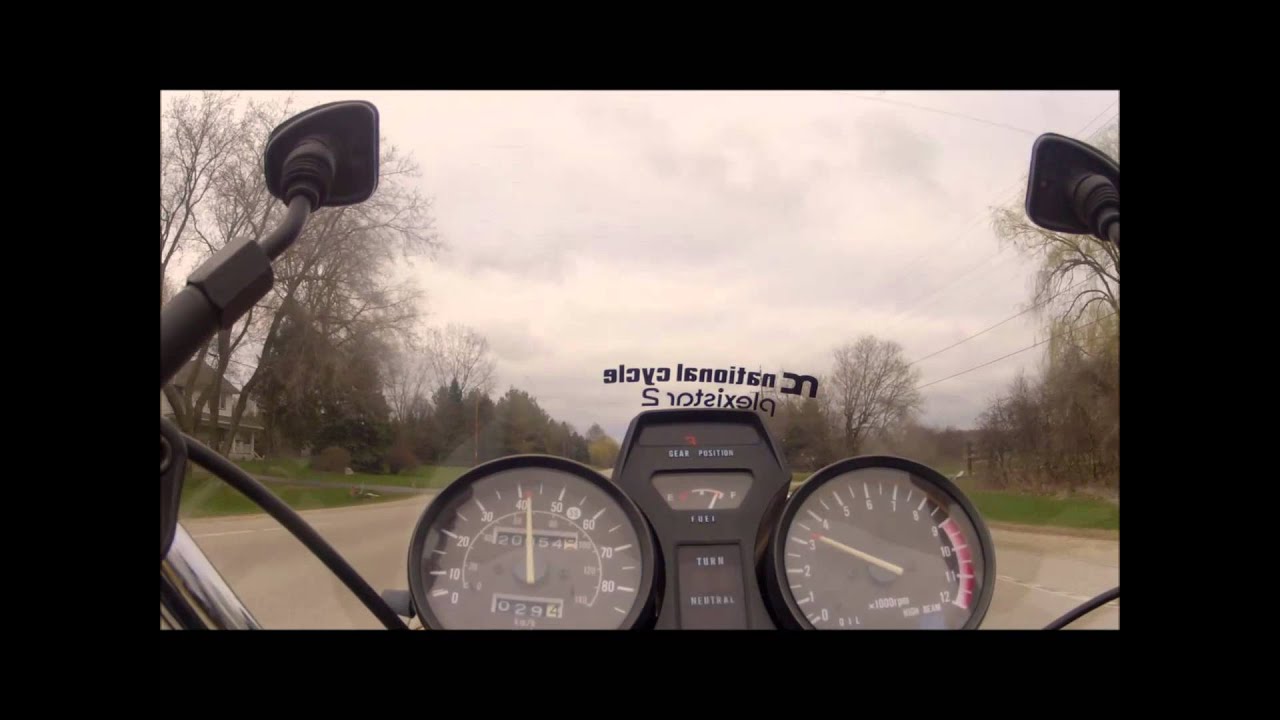

                  Watch the Tach starting at the 2:40 mark -- nearly 80 MPH in 4th and 5000 rpms...

                          Looking at your film clip it looks to me your tacho is not working
                          .sounds like she is reving well.
                          Try a different tacho from fleabay maybe . before you over rev it!!

                            I just watched your video, there is no way you were doing 80 mph at 4 grand, replace your tac.
