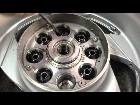

Has anyone successfully removed the bushings (cush drive?) from the rear wheel without destroying them? Were you able to re-use them? I'm thinking of powdercoating my wheels, but I doubt the rubber will hold up to the 400 degree temps.https://drive.google.com/open?id=0B9zH8w8Civs8ejBJWjdvYi1LNTg&resourcekey=0-hlJp0Yc4K_VN9g7Jyy4KQg&authuser=fussbucket_1%40msn.com&usp=drive_fs

I used a drift to force out the nipple side
worked like a charm of rme
30 yr old bushings went back in used a bit of lube on the nipple
Not sure what you mean by nipple side. Mines a shafty if there's a difference. They're pressed into a blind hole, so I guess I'd have to use some sort of puller.Originally posted by JEEPRUSTY View PostI used a drift to force out the nipple side
30 yr old bushings went back in used a bit of lube on the nipplehttps://drive.google.com/open?id=0B9zH8w8Civs8ejBJWjdvYi1LNTg&resourcekey=0-hlJp0Yc4K_VN9g7Jyy4KQg&authuser=fussbucket_1%40msn.com&usp=drive_fs

Just lever them out... lift the edge & spray some silicon around there first. Yes they can be re-used but new will feel better....1980 GS1000G - Sold

Yep they get hard as a rock after 20 or so years. So you end up with no more cush in your driveOriginally posted by GS1150Pilot View PostThose things degenerate over time. If you removed twenty or thirty year-old rubber dampers, replace them with new. I just did this for my 1150. Cost me all of $50.My stable
