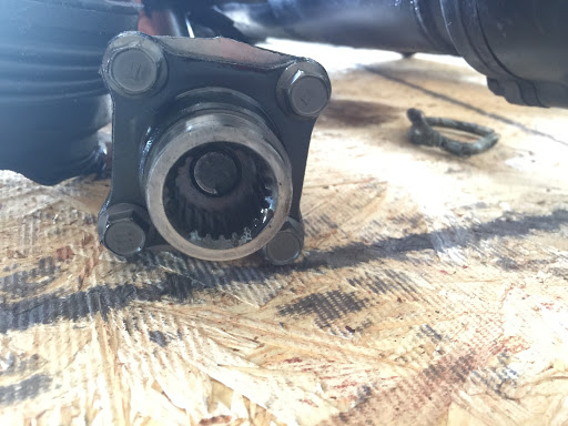

              Photobucket shenanigans ruined the image links... I'll try to repost them elsewhere.
              My secondary drive gear broke twice already... more details in this post. http://www.thegsresources.com/_forum...ime-in-2-years

                        Originally posted by gordinho80
                        Thanks.
                        Am comparing the photos to what I am learning.
