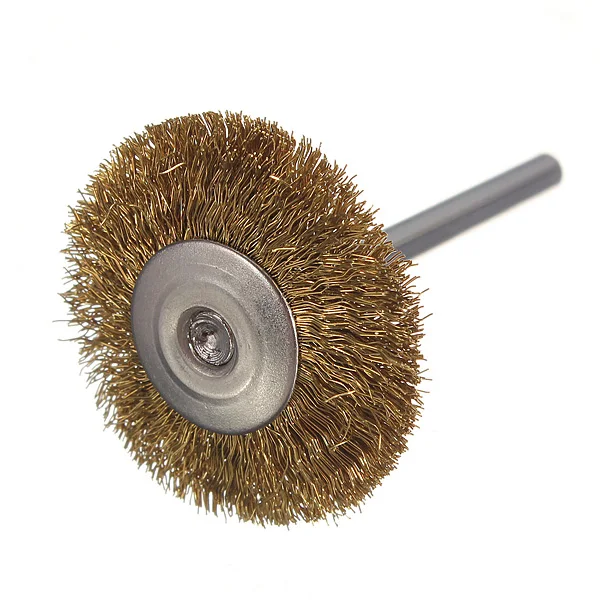

            Hard to tell from the pic.
            If it was me I'd grab one of these for your drill and clean it up to assess how bad it is:
