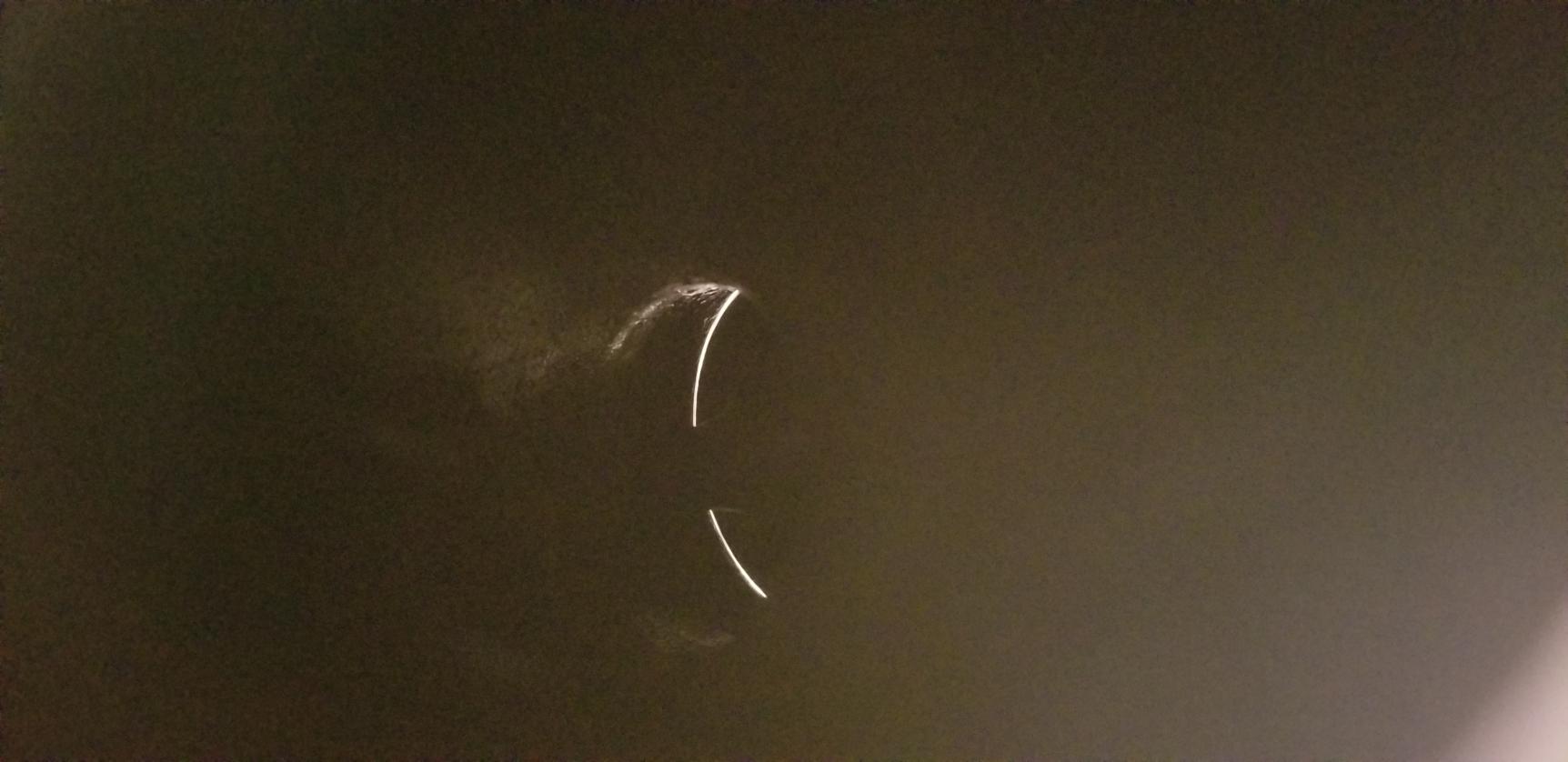

          Thank you so much for actually saying how it could be wrong! I didn't even realize that the mark could be off by 180?. I at some point after I out the head on I had rotated the crank to check nothing was seized and did recheck TDC on 1&4. I just re did the timing and have about 110psi on 2,3,4 but looks like at some point while bringing the head back to the garage I possibly bent or got some kind of debris in the intake valve on 1 so I have 0 compression there. Now I have to figure out whats the easiest thing to fix the valve issue so I can get the bike together again soon.

              Well at first it was because I could feel the compression coming out the intake. Then I looked in the intake port and saw a ring of light around the valve from the work light I had pointed in the spark plug hole.
                Yup... pulled it apart and found a bent intake valve😒 now I have find another one for cheap hopefully
