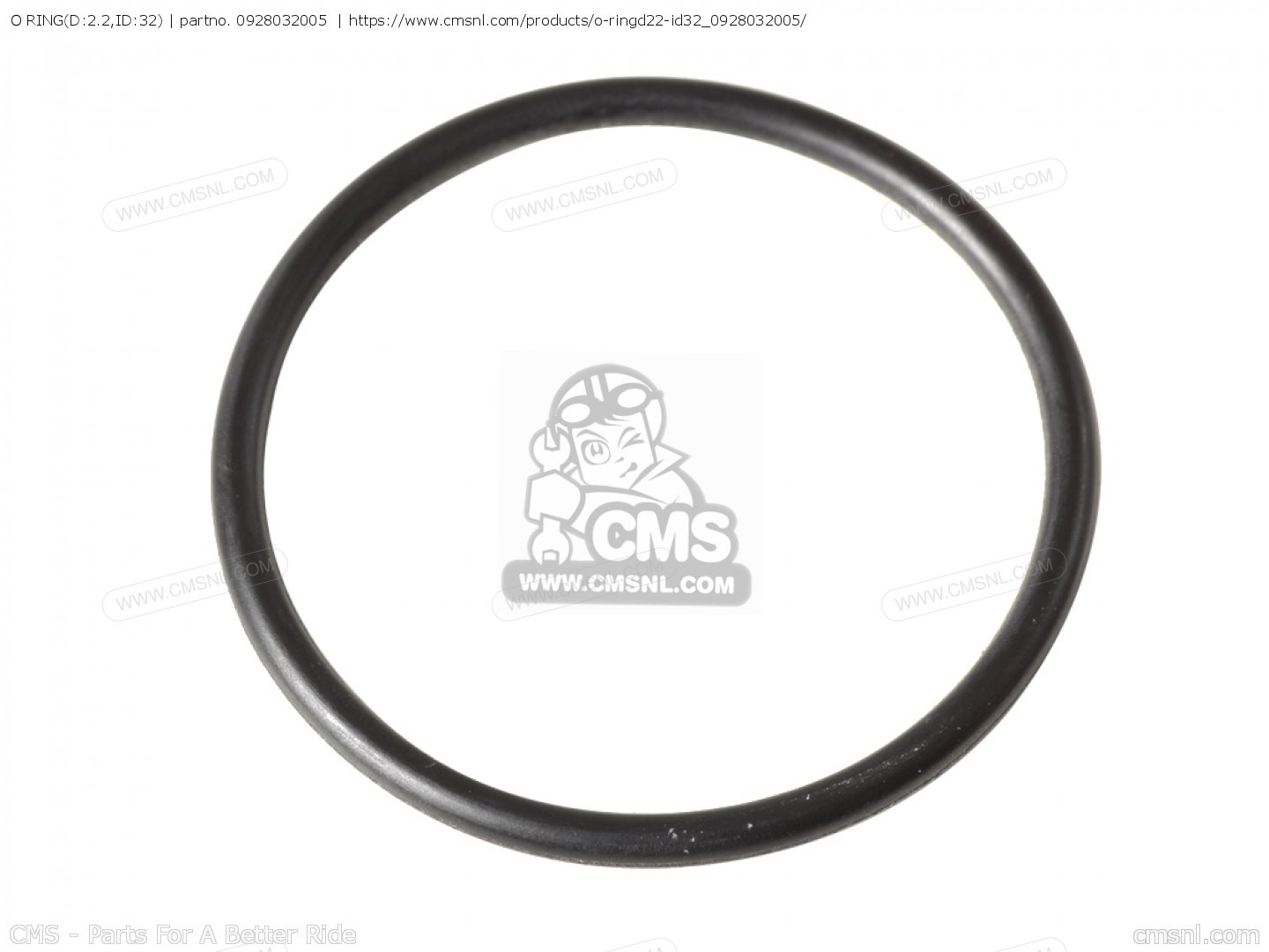

    Never had a problem with oil oozing out the top of the case at the cap until this year. I must have lost this O-ring when I changed the oil last winter. Since I don't really need anything else to make it worth placing an online parts order, and the closest dealer is further than I want to drive for this, is this something on which I can use an o-ring that my local good hardware store may have? does the part # reveal anything about the size? I have to stop there on the way home anyway.

    The "32" in the second part of the part number indicates that the inner diameter of the O-ring is 32 mm. I just went out and measured the O-ring on the filler cap of my 850, and confirm the ID is 32 mm.
    The thickness appears to be 2 mm, but the O-ring has been on there for some time, so it could have been slightly thicker originally.
    A normal hardware store O-ring will work fine for that application.
    I suggest that you take the filler cap inside the store with you, and select an O-ring that most closely fits the groove in the cap.
