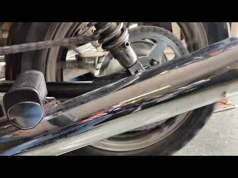

                Old 630 chain, lub-dubbing along.
                Now I know why. There were lots of links at least this stiff:

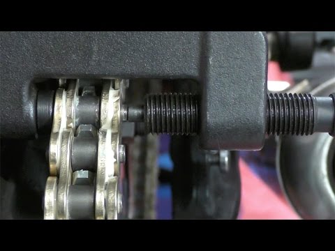

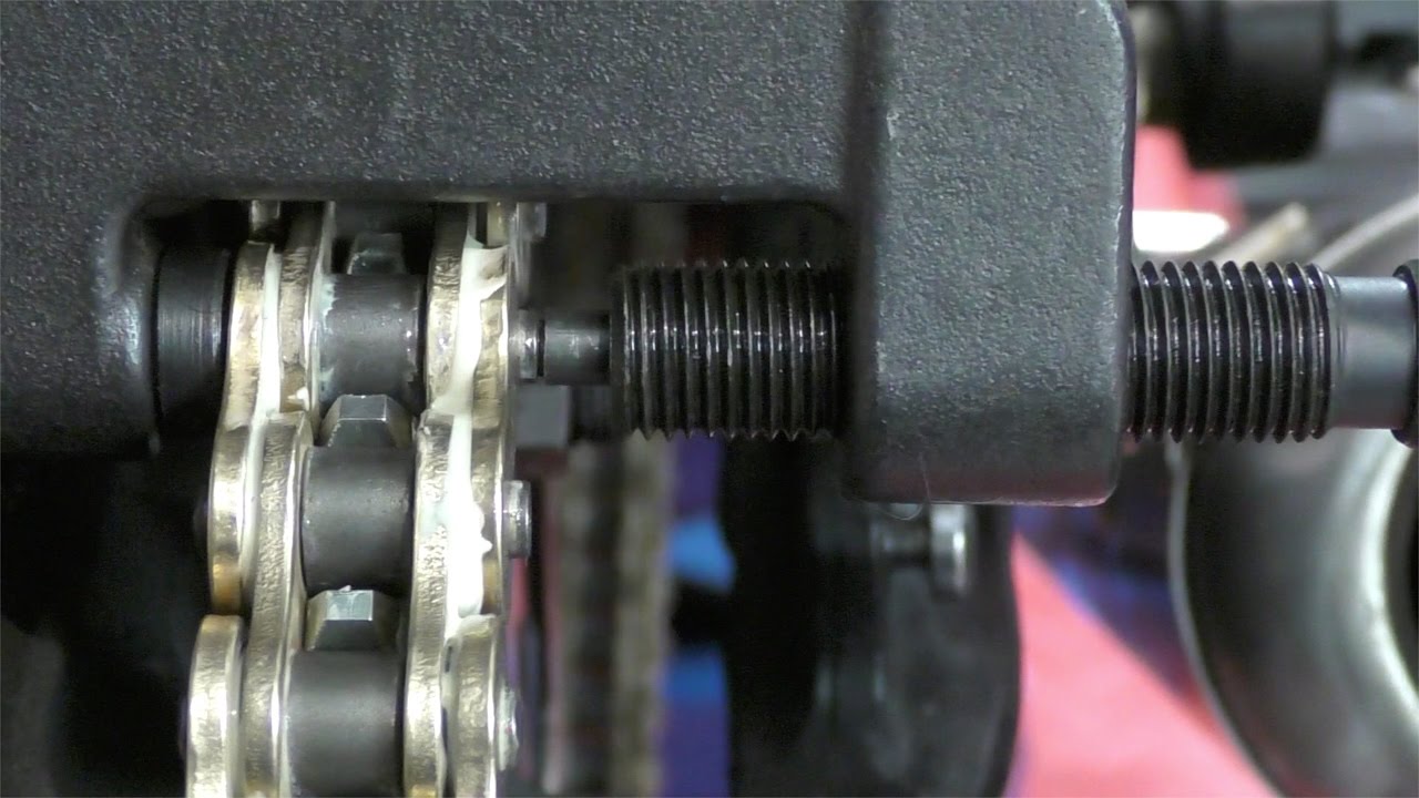

                  I found what I thought was the most thorough video tutorial for using the chain tool I bought. Happens to be from Delboy’s Garage. I know Andy of Andy’s Motorcycle Obsessions has no good words for Delboy, but anyway, here that is.
                  I forget to measure the head of the pins to be flared before I started flaring so I measured the pins of one of the removed links at 5.2mm. When I got the pins flared to where the flaring tool seemed to bottom out, I reached 5.475mm. I believe that should be more than adequate, but please someone tell me if it’s not. This is my first time doing this. Prior to flaring, I pressed the plate on exactly as far as the neighboring links. And after flaring, measured that as still good.

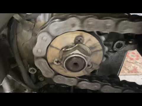

                      Having just recently torn this engine down, (Remember, it's the donor I bought from Norm back in April) Both of the front sprockets on my blown up engine and the one on the donor came off with very little effort after hammering back the locking tab of the lock washer. They were both just barely snug. When I remounted the front sprocket after the rebuild and today, I put the bike on its wheels and had my wife stand on the brake pedal. Had no problem torqueing the big nut to 90 lb-ft (IIRC). Then peened over the lock washer tabs on 2 sides. Is 2 sides overkill? I don't know. But I can't think that it would hurt. Any Objections?

                            MrBill and I put a crowbar in the rear rim and still couldn’t get it to budge. That sprocket is definitely factory torqued.
