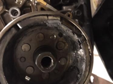

    My 1977 GS750B generator has melted the rota, despite trying for 2 days now i can not budge it from the crankshaft, has anyone any tips to get it off before i have to take the whole bottom end to a local engineer and ask them to try get it off?.

      I gotta ask. Is it the coating of the stator windings that’s melted? Or actually the rotor? Not doubting. But I wanna see pics, just for my own education.
        not a puller as such but tried the slide hammer as advised in the workshop manual
          The black resin that is around the outside has melted and broken away getting the case off

            WOW. That’s a first for me.
              I've never seen one melted like that, but that's not why it's stuck.
              In my experience, a slide hammer simply does not and cannot work (I once tried an absolutely gigantic slide hammer on a scrap engine; the rotor did not budge, but I'm pretty sure the crank and cases were damaged). You need a high quality threaded puller, some grease, and an air impact.
              I don't know which puller is correct for your engine; if you believe Google, it seems to be basically a large hardened bolt with 16mm x 1.5mm threads. For these bikes, I use a grade 12.9 socket head bolt (I have an impact-rated bit socket for this.)
              A low-quality puller or bolt will only destroy itself.
              Again, don't believe me or Google; measure those threads and verify what you're dealing with.
