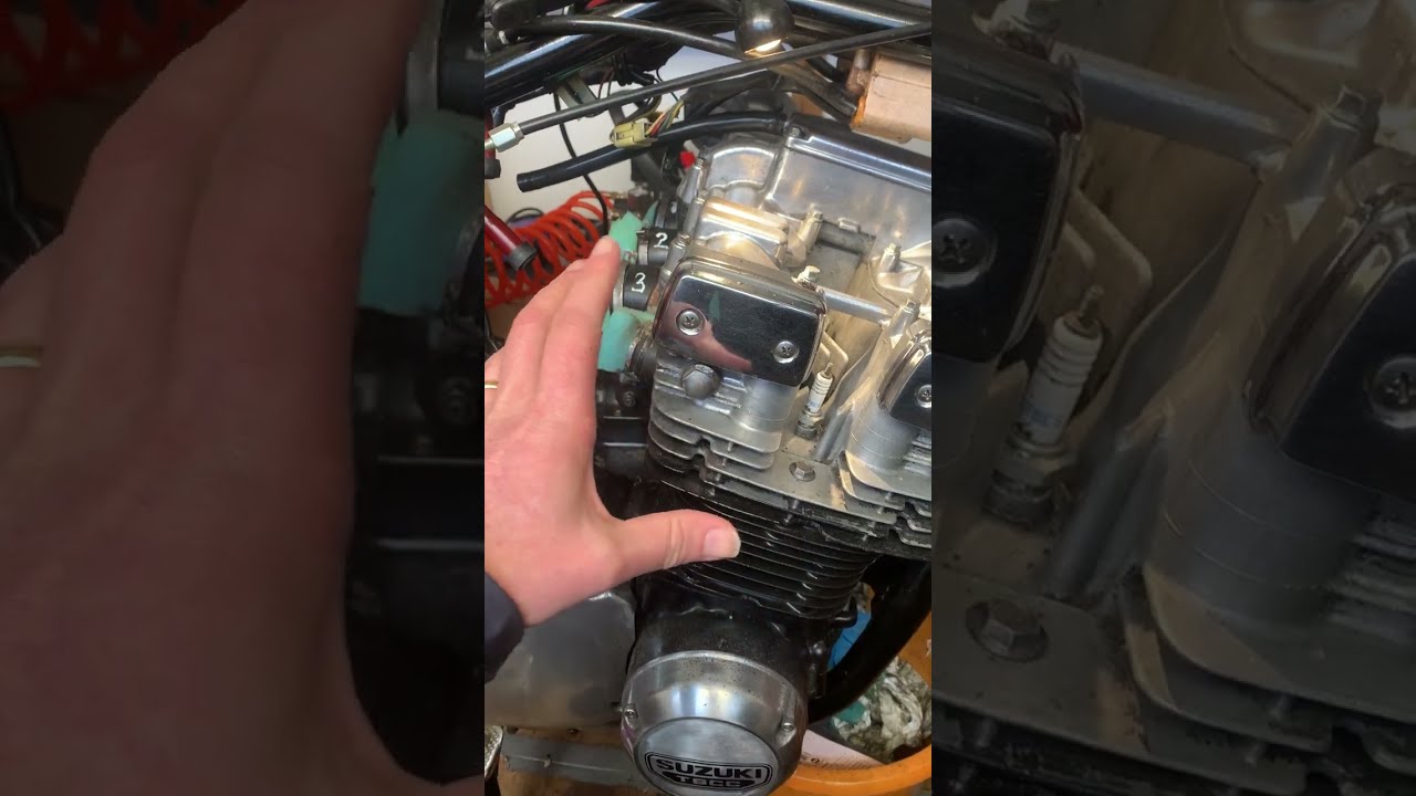

    Cleaning the cylinder head cover before removal I couldn't help noticing how bad the paint was on the engine.
    It pressed all my buttons.
    So started trying to get the old paint off.
    It's stuck like sh*t to a blanket.
    And is proving to be a very time-intensive job.
    Especially since methyl chloride​ has been removed from all commercial paint strippers available here in the UK.
    I'm using brass brushes, bits attached to the Dremel, and elbow grease.
    It's taken me two sessions (in between life, work, family, etc) to strip about 1/4 of the cylinder. I think I might have started something I don't know how to finish!​
    Here's what it looked like the other day...

      On my 1100 motor I removed it from the frame, fitted it onto an engine stand and soda blasted it (harbor freight unit) with the covers on and all ports and orifices sealed. Wouldn't recommend any harsh medium as it will pit the aluminum.

        Blasting is your best bet
        soda, or walnut shells
        Avoid glass beads, you'll spend more time cleaning up than blasting
        vapor blasting is a finishing process, you can do that after paint removal, if you want
