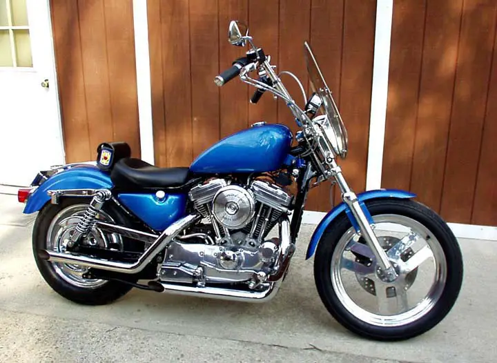

                I have doing motorbike painting since 2012. And I use airbrush for painting. Sometimes also do car and other painting job. To do airbrushing Iwata is my first choice also has a badger airbrush. I always picked airbrush and compressor and other accessories from this source. I have painted 10+ bikes and parts past month. Here are some of painted works……………
