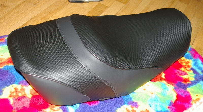

This is the Sargent's Cover I did last month for the 79 GS1000L
You strip off the old cover and replace it.
$59 Ready Fit Cover kit.. COlored piping is $20 extra..
Part RF-372 for the 81 GS550L
RF-37
They make them to order but the turn around is fast.. They shipped it 2 days after I ordered it.
The kit comes with the cover, new welting for the pan edges and a sheet of plastic to make a slip cover for the foam..
You can get it smooth, pleated or CarbonFx (the one I did)
You'll get the kit and when you first try to put it on you'll be thinking there is no way in hell this will fit. Take you time, get your weight on it to compress the foam and pull the cover around.. It'll come out nice and tight. I ended up working it on the floor with a rolled up beach towel under the seat to help compress the step.
