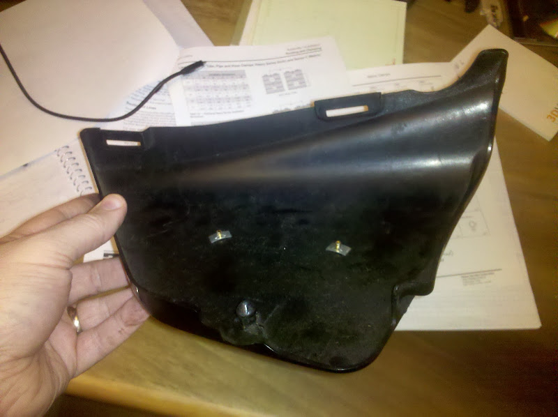

in my quest for a side cover for my bike all the online parts fiches i have seen show there to be on mounting tab on the top of the cover. the left side i do have for my bike has two mounting tab holes. i dont kow if the picture is misleading or if a PO has made mods to make this work. any help would be great thanksTags: None

the problem im having is the side cover i do have has TWO mounting slots on the top. my bike has TWO tabs to mount the covers. the online parts fiches for my bike the cover only shows ONE mounting on the top. the only thing i can think is i don t have the bike i think i do which is a 80 GS850GLT. so what gives might the pictures be incorrect?

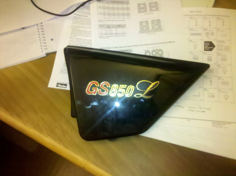

Are you looking for the cover or the grommets? I have a cover in the for sale section. It was sold to me to fit a 1981 gs1000l but it's for a 1980 850l. It has two slots on the top and one pin on the bottom. pics aren't the best but I could email beter ones.

I nabbed some quick cell phone pics of my left side cover. If you want to see what the decals should look like, have a look in the GSR gallery.
