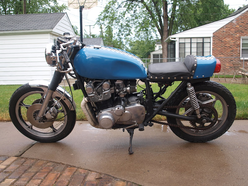

    Here is a pic of the dash as of last year. There will be some small modifications coming this week.
    As you can see, no key. The toggle switch controls high beam/low beam headlight. There is a neutral and oil light. The kill switch on the right hand controls still kills the motor, but the starter button works the horn. Other than that, there isn't anything else. I have a total of three wires going into my headlight bucket, which I think is awesome.
    The bike's wiring was in a sad state when I got it, and after struggling with it for a few seasons, I yanked it all out and started from scratch a couple years ago. There is a thread about it here somewhere. Anyway, it has been much more reliable since I greatly simplified it.
    Since it is garage kept whenever I am at home, and I live in a pretty safe neighborhood I don't worry about it getting stolen from here. And I rarely leave it parked unattended in a bad area. Also, it doesn't just "start up", there is a trick to it. I figure if someone thinks about stealing it, there are going to be staring at it for quite a while before deciding to move on and steal the bike next to it. Also, I don't worry about someone pushing it up a ramp to get it. There are way more bikes out there worth way more money to merit stealing this.

        Did a little more paint work and assembly:
        It was overcast, and I was trying to get some shots in before the rain. Not the best conditions for photos.

                Looks great! Can I ask you where you got you clubman bars from? Look very nice. Also noticed your front brake looks different than most.
                • beergood
                  I am pleased to report that last night I applied gasoline to the inside of my tank for the first time in about a year, and it kick started right up. I was worried it would take a while, and was quite surprised when it stated on the first real kick (I did do some priming kicks, which are necessary when running without a battery).
                  I ordered the bars online years ago. I don't remember where I got them from, but I know they cost about $20.
                  As for my brakes, they are stock, I just stripped and polished them.

                      I can't see why you'd spend $40 for paint when you can achieve that nice of a job otherwise. Well done. But, I have to say I'm not really fond of the cliche checkered flag design. But that's just me.

                        great looking bike! how is the seat mounted?
                        • skubasteve!
                          Love the bike, looks great IMO. I would like to know how you applied the license plate to the spring? Did you just fab up a mount or what?
                          • beergood
                            The seat is mounted to a pan I made out of sheet steal. There are build photos in another old thread of mine, if you feel like looking.
                            The license plate is also mounted to a homemade bracket, but I need to make another one, as I was politely informed by the police that the license plate needs to be horizontal.
