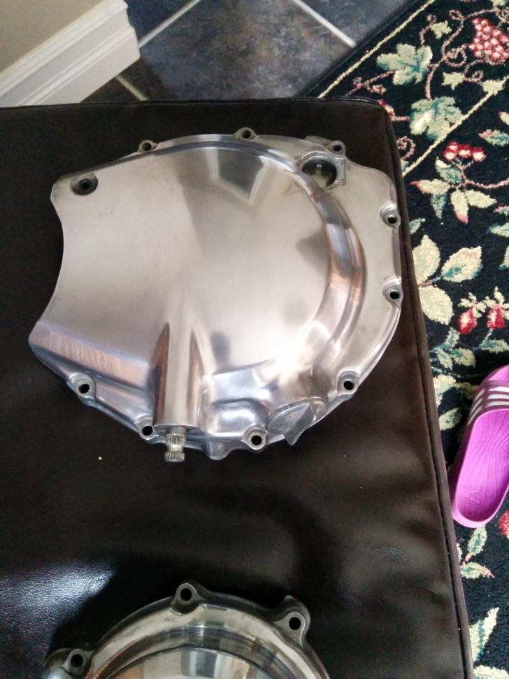

    I just did this recently on my GS 650, first thing remove the cover(s) from the engine itself. It will make it far easier to polish them up correctly. Be aware that new gaskets will need to be purchased most likely. Next buy yourself a variety of wet/dry sand paper ranging from 150-2000 grit. The first course of action is to remove the clear coat finish on the aluminum. I personally used 150 grit to sand off this clear coat and expose the aluminum, it does take some effort but is worth it. Once the clear coat is removed, fill a large bucket with water and place the cover in it. Begin wet sanding with the 320 grit and work your way up to the 2000 grit sandpaper. Once you're done with the sanding I finish the piece of with some Mothers Mag/Aluminum polishing compound which works wonders.
    Its a pain to do but if done correctly it looks amazing.

      Removal of the remaining factory clear coat is the first step. Whether you use chemicals or abrasives is up to you, but if you use abrasives, know that you will end up using finer and finer grades until you can use a buffing wheel in a machine, whether it is a bench-mounted device or a hand-held drill.
      As SpecialK has mentioned, it's not easy, but the results are worth it.

            Rouge is pretty much useless. If you want to bring back a nasty looking engine cover you need heavy black cutting compound and a sisal wheel on a real power buffer.
            Use chemical stripper to remove the clear coat first.
            Before the power tools though you need to sand out heavy corrosion pitting with the finest sandpaper that will do the job. 220 grit is a common starting place. Work through 320 and then go for the wheel. You don't need to use a fluffy wheel and rouge at all unless you are going for a chrome look like Steve.
            The factory Suzuki look is a brushed finished, not polished. If you are using sandpaper you can stop at 600 or 800. No reason to go higher.

                    I did these covers with the sisal wheel and black cutting compound. Followed with POR-15 Glisten clear. Came pretty close to replicating the factory look.

                          Depending on how convoluted the surface is, I might use chemical stripper or a fine Roloc-type wheel from Harbor Freight. Used lightly, it's great for removing the corrosion that happens when the clearcoat is gone. If you use the Roloc lightly, you will end up about the same as a 600 grit paper. That is when I move to the spiral-sewn cotton wheel (from HF) on my Craftsman grinder (going to get an official BUFFER for the new shop) and the white polishing compound. I have found the best prices on the compound at Lowe's or Home Depot, and usually buy out their meager stock (3 or 4 tubes) when I re-supply. Apply enough pressure to the wheel to slow the motor down a bit and keep the part moving, or you will burn a crease in the metal. Rotate directions until it is all pretty shiny, then give it one final pass with some fresh compound to eliminate most of the swirl marks.
                          Now for one of my favorite pics:
                          It doesn't take all that much to get there, and, as Cyrano says, it's rather easy to keep it there.
