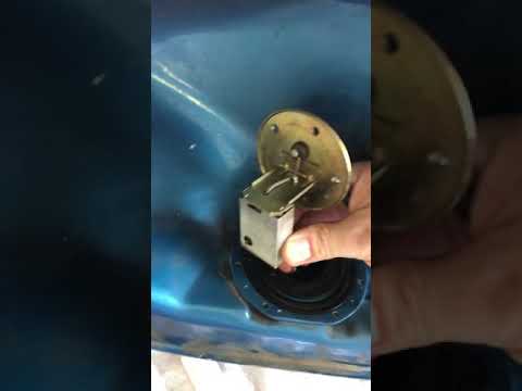

                I case you need help getting the sending unit back in the tank, here's a short video.
