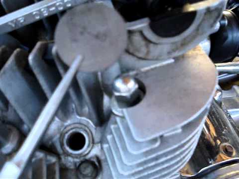

                You can make a shim tool. It pushes down on the side of the bucket to push it down, not touching the shim, this allows you, usually with a magnet, or needle nose pliers to remove the shim (shim over bucket). They're cheap enough to buy. This video shows the tool in place. The diameters for all shims in those years are the same. Not anything you can do about. They have kits on EBAY that have all the shim sizes. They don't cost that much. I have cam followers on my Suzuki, so I don't need shims.
