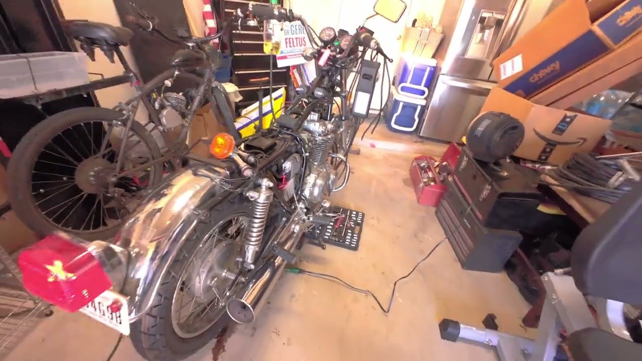

                    alright, here is a video of it running
                    while running, i showed the carbtune, and adjusted the sync back and forth, and then put it back to center. when i blipped the throttle, it hung up (edit, i realized watching it back, i didn't put it back perfectly centered. even still, with it spot on, it comes down but it takes several seconds).
                    i then showed the temps after running for a couple of minutes

                            The video was interesting. A question, when you are adjusting the carb sync and it runs more evenly, are you opening the RH carb more in relation to the LH (good cylinder) carb?

                              i believe that when i turned it and it started running better, i was turning the sync screw counter clockwise, which on my carbs, opens the right butterfly. which i suppose would make sense if the right carb is currently running leaner than the left one.
                              edit: hang on, now i'm getting confused, lol! currently it's lefty that's running hot. let me re watch the video real fast.
                              edit 2: okay, so at 2:37 in the video, i realized the screwdriver was out of frame, but there where i paused turning it, it was centered up and the carbtune was balanced. when i turned clockwise, the idle cleaned up, and that was closing the right butterfly in relation to the left one. so it still stands to reason that opening the left butterfly would clean up the idle if lefty was running lean and having trouble firing. (edit 3: actually, the idle set screw props open the left carb, and the sync screw adjusts the right carb in relation to it. clockwise closes the right, ccw opens it. edit 4: no, the idle screw props open the right hand carb. turing the sync screw ccw opens the left carb in relation to it and cw closes the left carb in relation to it)
