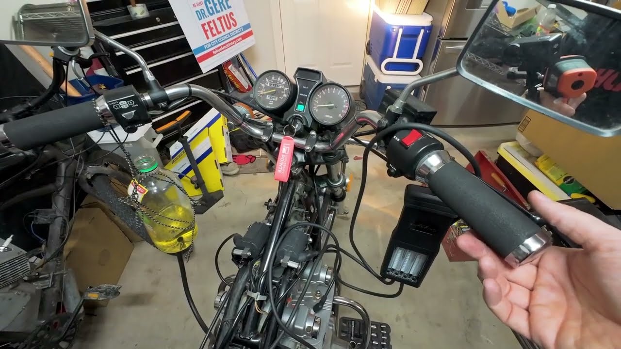

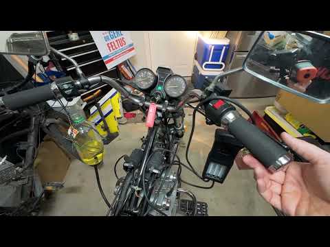

    yea, i will tomorrow when i take it back apart. i took video of it but my video cam refused to focus on it.
    here's a video i made of todays carburetor adventure.
    engine run starts at around 4 minutes. i ran it from pretty much stone cold until it was fully hot.
