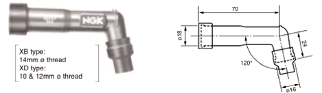

 Well... the parts guy at RMC mis-heard me and thought I said "XD05F", instead of XB... I looked them over and frankly, I don't think there is a difference in the base cap itself. The XD is supposed to fit 12 and 10mm threaded plugs, and the XB is for 14mm, but I tried the XD plug on a B8ES plug and it fits just fine.
 I'm thinking that the difference is actually in the supplied rubber boots that go over the plug. If that's the case, I'll just use the boots off of my existing caps and should be good to go.

 Oh, and I was right about the XD vs XB plugs... it's just a diffenence in the rubber boot on the plug end. The hold in the XD is smaller for the 10/12mm plugs... I used the rubber bits on these two caps from my original caps and all is good!
