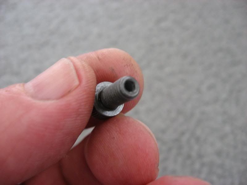

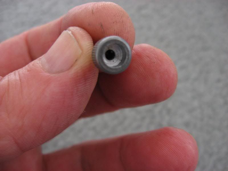

 Diy synch toolHey, whats your thoughts on this? Zirc grease fittings come in m5 thread and they have a fairly small hole to act as a restrictor. The fitting would screw into the carb boot and you slip the synch tool hose over the other end...-Mark

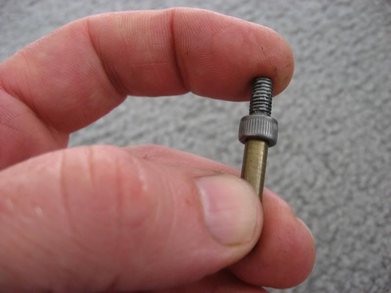

 I just use 1/8" copper tube and thread it. Works fine. You don't really need a restrictor if you use heavy weight oil in your tool.

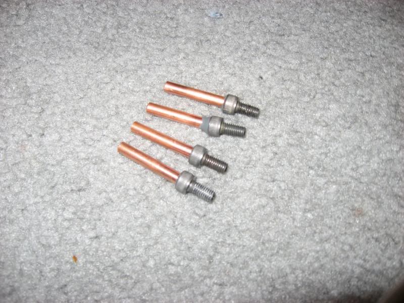

 Nice Ed! I like the idea with the extensions. Well I checked and adjusted the carbs reset it all to factory, then a tad rich. Seems to have done the trick, was able to balance the carbs and my synch tool worked pretty well.. I used 10w-40 oil and still had some flutter in the fluid...-Mark

 You have a picture and/or dimensions on your sync tool?Originally posted by mvalenti View PostNice Ed! I like the idea with the extensions. Well I checked and adjusted the carbs reset it all to factory, then a tad rich. Seems to have done the trick, was able to balance the carbs and my synch tool worked pretty well.. I used 10w-40 oil and still had some flutter in the fluid...

 Just curious about it, as most home-brew gauges are using lighter-weight fluids, and therefore have to be much longer than is convenient.

 Thanks for the picture.
 As I suspected, just a bit bigger than average.
