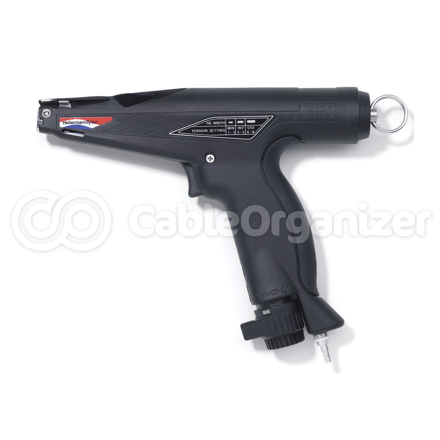

          And the tool?
            Just hands

                Originally posted by tkent02 View Post
                And the tool?
                The Mark 7 Pneumatic (MK7P) is built to perform in demanding production and manufacturing environments. Heavy duty precision parts ensure repeatability in the tensioning process. The MK7P fits comfortably in the operator's hand, reducing hand, arm and wrist fatigue. Due to its ergonomic features, HellermannTyton's MK7P
                Except at $835 the correct clamps, even at dealer prices, would be a bargain!
                  More than almost any GS I have ever bought. I'll stick with the $3 Suzuki clamps.
