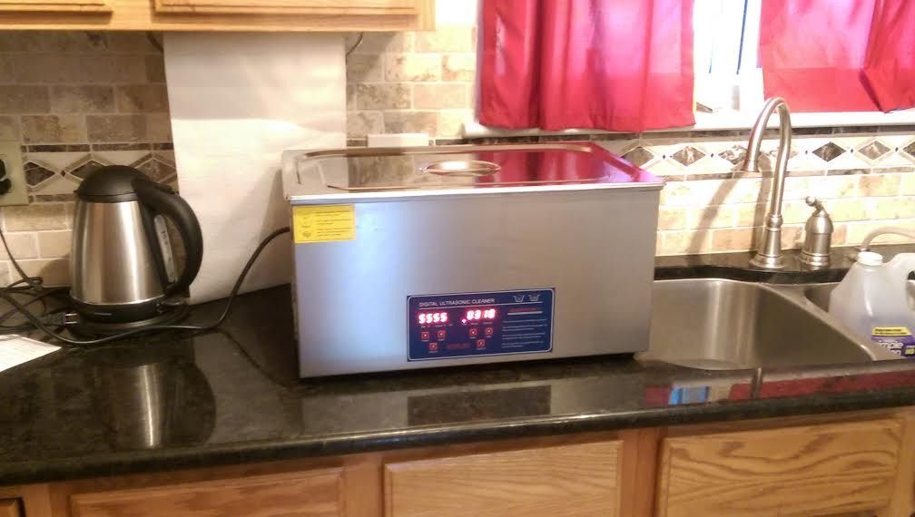

 It got here, or rather it's been here a week and I just got here. This one:
 Cheaply made, the instructions and labels are worse than those with a 1965 Japanese bike. Says not to fill it above the line, guess what? There's no line. I'm guessing an inch from the top is OK, just so it doesn't overflow? Maybe I should measure 22 liters into it and mark the side of the tank? The power cord is some goofy foreign thing that I've never seen before, and I've seen a lot of them. At least it comes with an adapter, which works. The heat is slowly getting hotter, up 6 degrees C in 15 minutes. Not really that impressive.

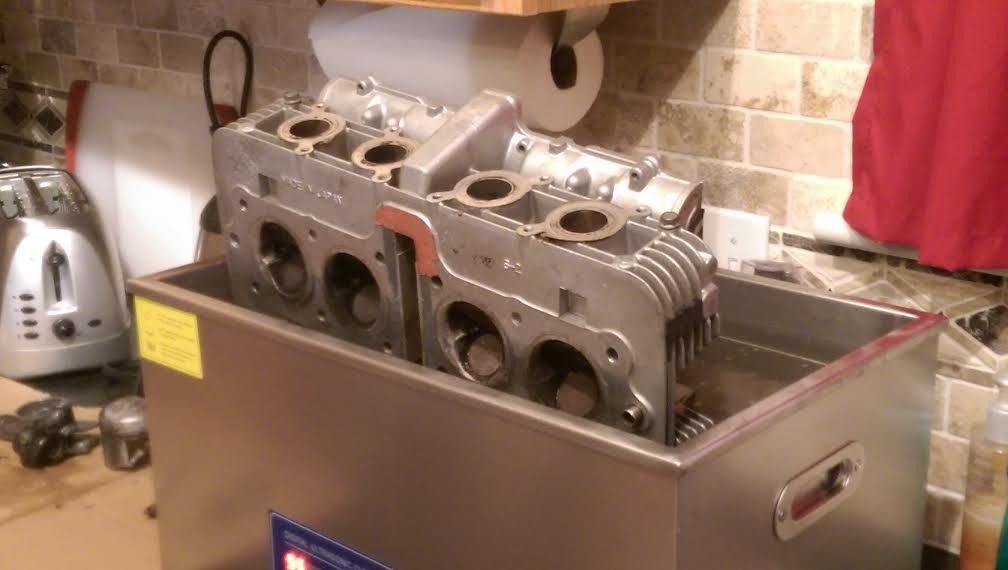

 Put a 650 head in the basket, it fits. A 750 or 1000 head will fit with no basket, will have to rig up something to hold it off the bottom. It's been in there fifteen minutes, the water is definitely getting murky.......Last edited by tkent02; 07-02-2015, 07:06 PM.
 I need a way to carry 6 gallons of hot water out to the garage. OK in the kitchen this time because my wife wasn't home. If I dropped something heavy on her new countertop it wouldn't go well for me. Got away with living dangerously this time.
 Fits the head, a lot of dirt came off in a hurry.
 Didn't really get it all that clean, even after a lot of cycles. There is still a stain from the old baked on crud around the spark plugs, there is still some carbon in the combustion chambers. I think the mass of the head is just too much for it. It did better on a valve cover and some smaller parts like a master cylinder and some pistons.

 It's heated, I only went to 55 degrees C. Maybe hotter is better? It says it goes up to 80. I'll try it. Also I didn't use much of that detergent, maybe I'll try a lot more. You using 9-1 on that Brulin stuff like they recommend? I didn't go anywhere near that much.

 Got it hotter, added more detergent, did a few more cycles, the head is getting clean now. Not removing paint but the carbon is gone, it looks really nice....
 One more cycle and........
 Snap!!
