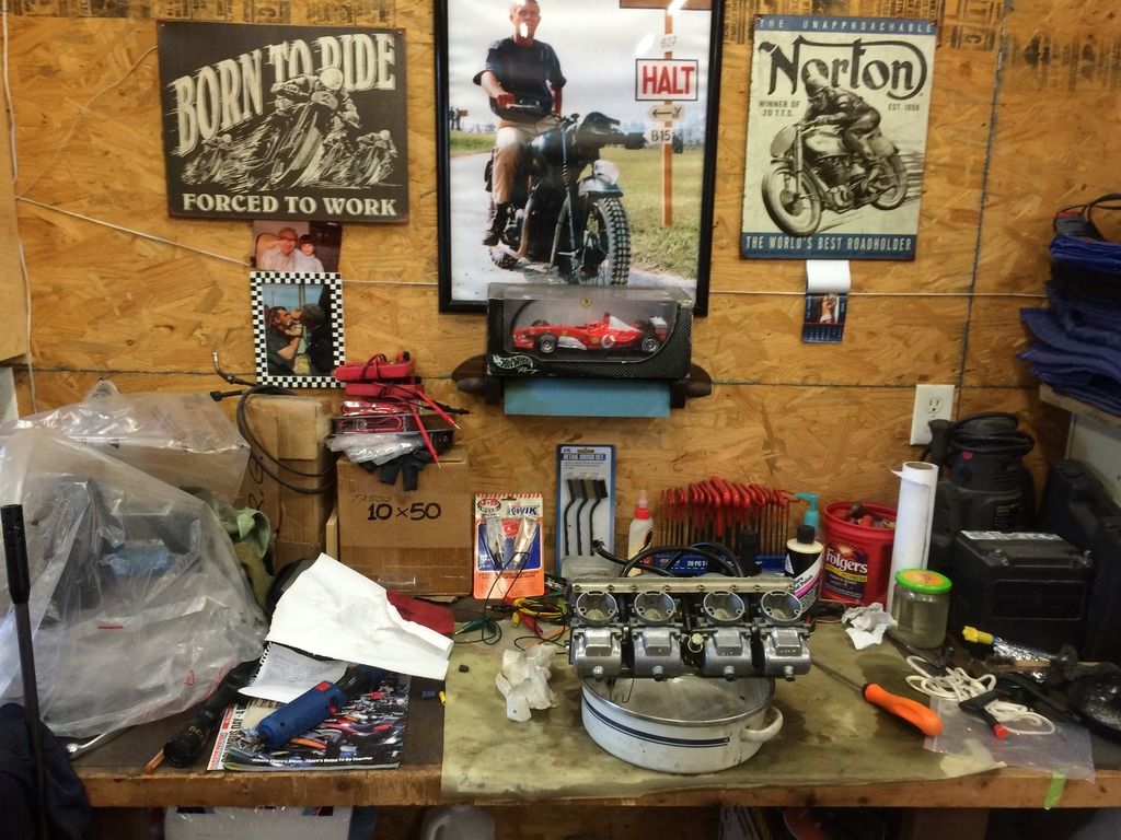

                  got the carbs partially dis-assembled and while I've seen worse, the two left carbs are pretty nasty inside.
                  Here is my carb work station with Steve McQueen offering inspiration:
                  the float pivot pins are all stuck of course but before I do something stupid I have a couple of questions.
                  Are those pins staked in or supposed to be floating?
                  Before I hit them with a nail and small hammer is there a trick to getting them to move? These are the first I've seen where that pivot pin looks like a nail with a head on one side. Usually it's just a pin and I can tap from either side to break them free. Absolutely don't want to break the casting. That would suck.
