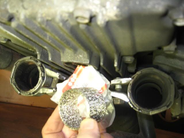

        • 13762
        Were available and not that expensive when I got a set in 2005 or so.
        Here is what they look like.
        I was really surprized to see they were a wire braid-mesh when I got them, since the originals seemed like porcelain or asbestos or something.

          The ones I put in my bike maybe 2010-ish or so were a different design yet, a sort of shiny, solid, slippery, and somewhat fragile and crumbly stuff.
          The material was a graphite and/or mica. I believe they were a sort of mesh core like the ones Redman shows with the mica/graphite type material. The ones in my V-Strom are the same type of material.
          I've seen automotive exhaust gaskets made from the same material (nothing with a tubular shape, though).
          The originals were sort of a cloth-like stuff; and when it falls apart the windings unspool. They're discontinued and superceded, so I wonder if they contained asbestos.
          Hmmm.
