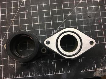

            My shipment of boots arrived today. I could be mistaken since it has been a solid year since I replaced the o-rings on my OEM intake boots, but I think the intake hole itself at the base looks smaller than stock? Anyone have measurements on what these should be? By my calipers these are 27mm at the base of the plate. 33mm inside the boot where the carb throat would seat, 39mm at the top of the boot. O-rings sit slightly proud like they're supposed to. Build quality seems decent; casting isn't perfect but seems adequate. Boot seems well bonded to the non-ferrous base. Will bolt those on my GLZ this weekend and see how they perform. I imagine at this price point it may be that they perish more quickly than OEM so a long term test would be in order.

              I'm curious....how long are these boots? Please let us know if that 27mm id is different than stock.

                Photos of original vs China are at the link (couldn’t get it to embed via mobile). As I suspected the ID engine side of OEM boots is 31mm vs 27mm for the China boots. Every other measurement is exactly the same. I assume this would lean out the engine a little, as it would flow less air/fuel mix into the engine? I may bolt them on anyway while I wait for new rings to arrive.

                    Here ya go, just copy and paste. Mine came in the mail yesterday and as stated they are a bit small on the intake side. I may port them out to match the head, we'll see.
                              I think the only way they are going to be useable is if you port them out. I had to increase my air fuel mix screws 3 turns out to get it to idle properly. I think I have a size larger pilot jet, may try throwing that in to see if it will let me cut the air fuel mix screws back in a couple turns.
                              EDIT: Only the idle was finicky, above 1/4 throttle it performed normally.
