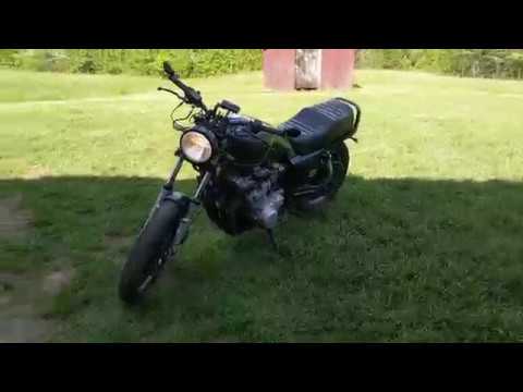

    Hey guys. In early 2018 I found a vintage Kerker 4 into 1 on craigslist for sale. Went and picked it up and threw it on my 82-750T. After the first few rides I noticed a light brown fuzzy material sticking around the exhaust cone. The 30+ year old exhaust packing was disintegrating and slowly blowing out. The more I rode the more blew out, and over the course of last season the bike slowly changed from sounding wonderful, to straight up ear-rape at anything above 6K RPM. So I need to pull the cone and baffle and re-pack. What type of packing would you guys recommend for the Kerker? Fiberglass, Ceramic, Wire Wool?
