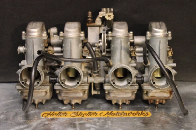

    I installed engine today and found something i have to ask about.
    I installed all new carb rubbers , both ends, in and out.
    There does not seem to be much overlap on carbs .
    If I shove carbs all way into head boots, then the airbox boots don't fully engage to the flange on carb.
    If I shove carbs into airbox boots all way to flange on carbs, then the head side is not in all the way.
    On head side of carbs there is a grove in carbs ( carb horn?) and the boots only just reach that. The engine is mounted in correct position. Can someone advise me please?
    Thanks
    If you look at photo in link , ( picture eight) you'll see the grove I mentioned, the boots are only reaching to the forward/head side of that.
    I assume that is wrong.
    Help.

    I dont have expereince with any 1000 nor any S, but my usual problem is the opposite; everything fits in tight.
    Maybe a picture of your situation might help.
    Picture that shows the boots on both sides and how the airbox is mounted.

        Is the airbox plastic on that model? On my 850 the plastic at the front of the airbox had bowed in some. A little heat on the plastic and I was able to push it back out. You should also compare all your new rubbers to the old ones to make sure they are not shorter.

          Airbox is plastic, will check that. New rubbers same as length as old.
          Are the carb to head rubbers supposed to bottom out against control assembly plate?
