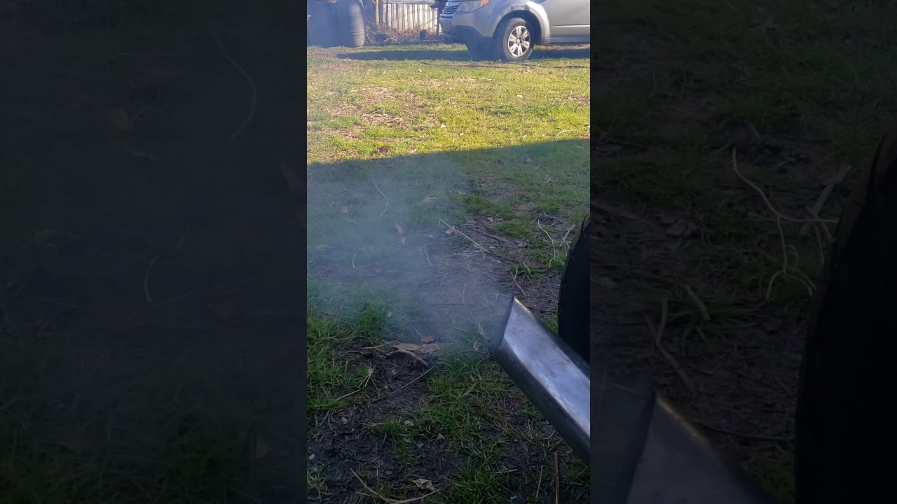

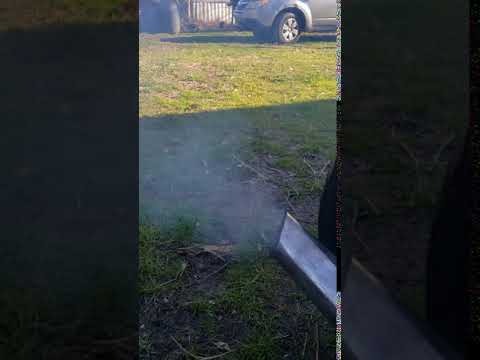

        Small update: Worked on the bike this weekend, just aesthetics, but did start the bike and let it warm up. I took some a couple videos (see below) of the smoke at idle and revving up to 1/4 throttle.

          Usually if it smokes on acceleration or constant throttle, it's valve guide seals. If it smokes on decel it's rings.
