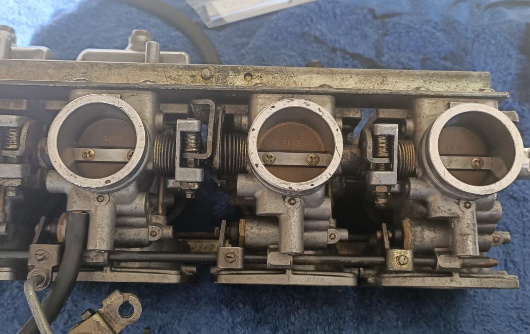

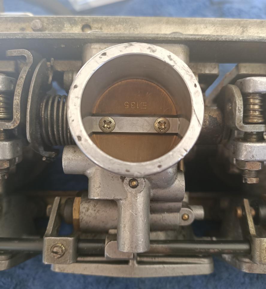

Hi all, I've just picked up a 1979 gs550 and it's running terribly so I thought I would strip the Carbs down. I'm new to the mechanics of bikes and was wondering if these Carbs are correct as they look different to a video I watched on cleaning the Carbs. Any help would be greatly appreciated.

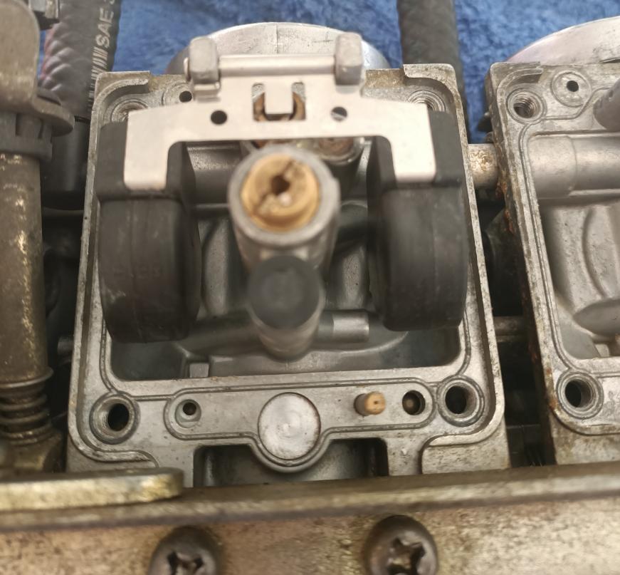

I'm definitely new and very fresh on the mechanical side of things as I've never worked on bikes, or cars for that matter before but I will definitely give things ago. I used the tutorial you posted above this morning to pull the Carbs apart ready for cleaning and that wasn't to hard.
I'm guessing I'll need some new jets as the main ones are 120 and 40 for the for the pilot opposed to 80 and 15 respectively.

The 1979 GS550 used Mikuni VM22 carbs. The tutorial linked above is for BS CV type carbs which came on bikes 1980 and newer.
Please download a manual for your bike which shows the carbs you have. Also, download the VM series carb tutorial. Both can be found here...
Do not waste money on "carb kits" order a VM carb O-ring kit from cycleorings.com and new float bowl gaskets from Z1. Worst case, you will need new float valves, which can be ordered separately.
Lastly, since it appears you are using pods make sure they are not the junky generic cheapies that block off the air ports on the carb inlets. Real deal K&N pods don't cause this problem, but they are not cheap.Ed
