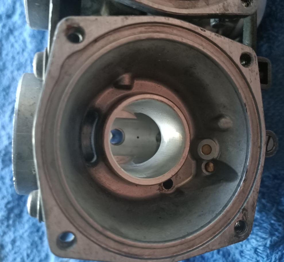

            Hi Guys, I pulled them apart today and soaked them. They are looking pretty clean but there is some white residue left on them that has gone hard so I'll start again tomorrow but only soaked them for 20 min then air dry them again with the compressor. IMG20210406175420.jpg
              All clean.
                Would anyone suggest replacing any of these parts now that they are cleaned?

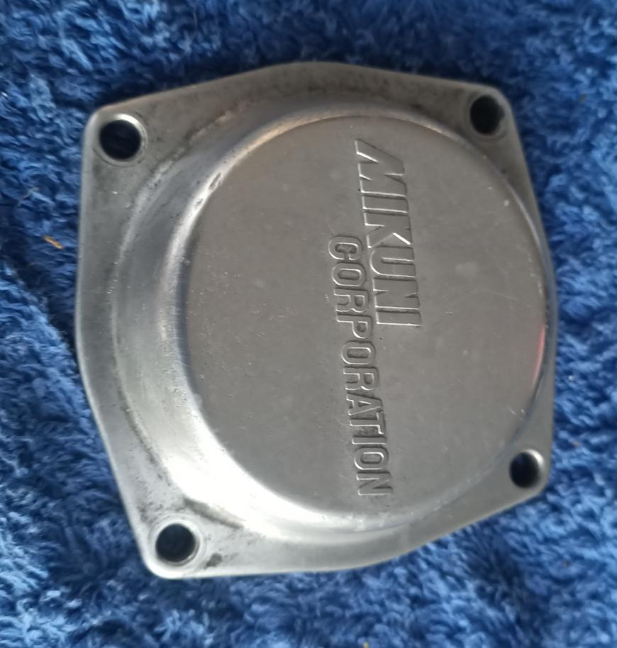

                  While I was busy I started to polish the top covers. 😁😁😁

                    They could be soaked longer, people usually do it for a whole 24 hours, and no, nothing needs to be replaced, just make sure nothing is left behind in them.

                      You didn't follow the tutorial. The carbs should be unganged and fully taken apart, including removing the pilot screws.
                        Your right Ed, I'm only new to all this stuff and it was a little daunting. I will give it a go tomorrow and do it properly 👍

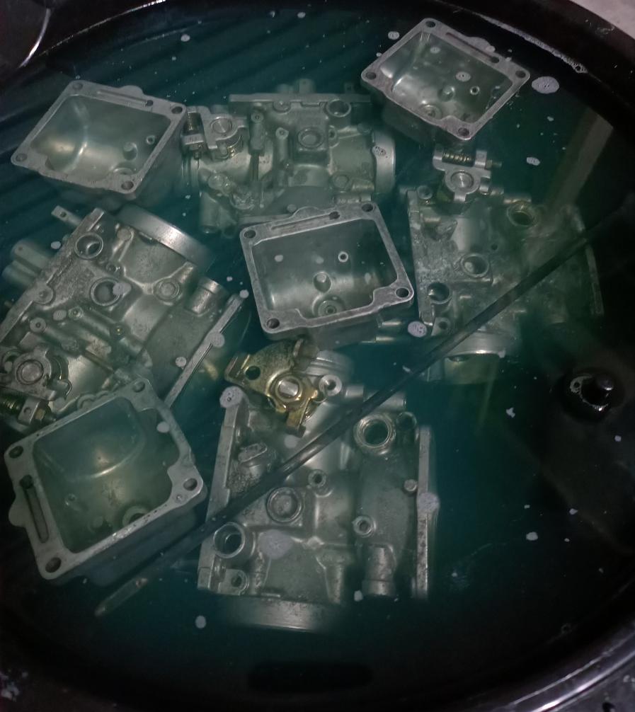

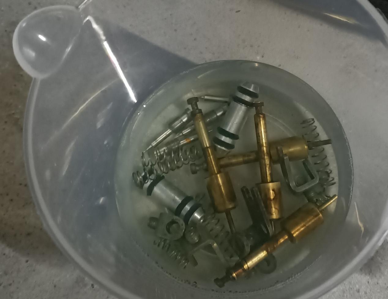

                          Finally dismantled the carbs completely tonight.
                            Soaking properly overnight.
