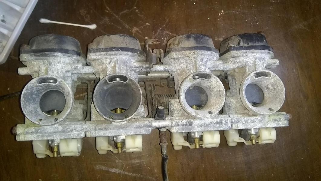

    I do not have the stock carbs for this bike; I have a set of Mikuni BDST 32 Flat Slide CV carbs that were installed by the previous owner (I think they are from an FZR600). I was wondering if anyone has any experience using these BDST carbs on a GS1100, and if they are worth keeping or I should look for replacements.
    The bike isn't currently running. I need to thoroughly clean the carbs and replace all the seals (luckily the diaphragms are intact) before I can can see how the bike runs with them.

          And, I would really need to clean and rebuild the carbs before even trying to see if it will run with them. The bike sat with the pod filters removed (maybe they just fell off since they didn't even have hose clamps on them ); the carbs have a lot of dirt and powdery oxidation inside the bores. And, all the seals are shot.
          In other words, I'd need to drop $50 on a rebuild kit and give them a thorough cleaning, just to see if there's any chance they would work.
          Here's a picture showing how rough the carbs are right now.

          Perhaps that's the best route. If jetted right, do the stock carbs respond well to an aftermarket exhaust?

              Thanks for that link, looks like a nice jet kit. I may start shopping around for the stock BS34SS carbs.
              Also, I think I fixed the photo in the prior post, sorry about that.
