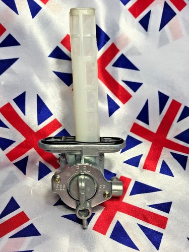

      #62
      Pet tap :
      I could not with human suction hear the pet tap seal thing go out and in.
      WHICH I COULD
      on others I have in box with the correct spring.
      the spring must be the issue as it is not the right one. that is lost on the garage floor the second it dripped out.
      is it a case of chop down other spring and hope that works .. ? spose has to be

        #63
        If you have another pet cock, in a box, remove spring from that one to see what kind of spring you will need. I'd think the length, dia., size & strength of material it is made from is very critical, Just me, sort'f close probably will not work correctly. Oh yeah, UKjulies, you've taught me something about the cables. I'd never heard of a fix for them, always thought got to be replaced. Thanks for the tip.

          #64
          Cables:
          def keep a temp fix cable in toolkit. the first time I used it mind I needed snips a didn't realise. Very hard to cut and I'd you don't it won't fit !
          Work cutter and temp cable in toolkit.
          pet tap:
          I don't have a single pet tap like the one in question. I have many gsx and others and the springs are not the same.
          So I can ow never know what the spring was like or size.
          thus I have a spring in their that clearly is producing too much force. I can only cut it down in increments and hope for the best.

            #65
            this is the one that o need a spring for.
            it is superb and worked well until I
            list the spring.

              #66
              list the spring.
              https://www.ebay.co.uk/itm/164850461...mis&media=COPY
              Cutting a spring only strengthens it, until it's too short.

                #67
                Kind'f hard to find if you drop them...ain't it??
