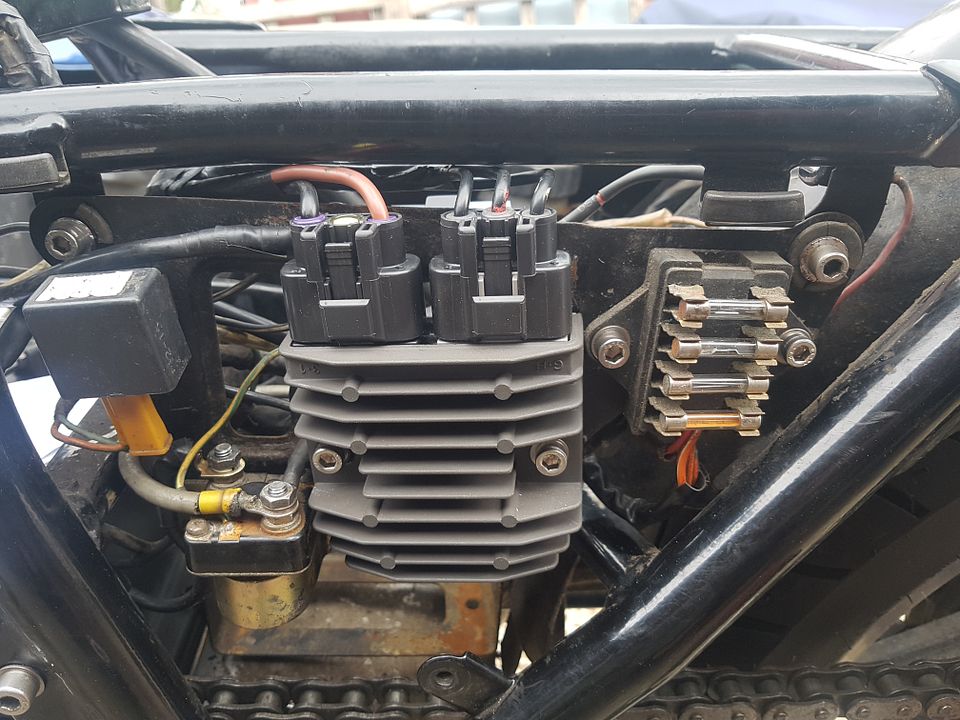

I put the one for Richs bike where the igniter was bolted to the battery box. holes line up so there it setsMY BIKES..1977 GS 750 B, 1978 GS 1000 C (X2)
This weekend I purchased a 2017 SH775 from Ebay wintersrec. They accepted the Make an Offer
. The Shindegen Gold Wing R&R 5 wire I had installed never caused a problem.

Would I be able to safely run a lithium ion battery on my gs1000 with one of these reg/recs ?
already got a nice anti gravity battery that I just removed from my 1200 scrambler, be a shame not to use itLast edited by Paint It Black; 06-22-2023, 02:11 PM.
- 14214
Yes, they are about as good as it gets on the control points of the regulation. I run one with a Shorai on my Husky.....1980 GS1000G - Sold

Yeah, up until the sh 232 dies after only 10+ years of ownership. Then it's time for the sh775
Of course this is a tongue in cheek response. Shortly after my purchase of my 79 1000, I bought one of those Honda regulators from duaneage. Straight forward swap and worked quite well most of two decades.Larry

Those Honda version Shindengen's are solid pieces, but they don't protect your stator like a SH775.Ed

I was under the impression that those batteries don't want to see more than 14 VDC. If true, the SH775 wouldn't be a good solution, because they charge at 14.5 VDC. What the SH775 does do well, is protect your stator from over heat damage. I'm unaware of any shunt type stator, whether 14.0 or 14.5 VDC that will do that.Originally posted by LMARJ2434 View Post

Well it was working fine for about a month,Originally posted by LMARJ2434 View Post
bumping an old thread, curious how this went for you before i go the LI-ION route
then I accidentally shorted the battery and totally fried it, dead as a dodo,
I replaced it with a regular lead acid battery
