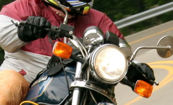

My '83 GS850G's running lights; OEM signals:
In that wiring diagram, B/W is the ground, Gr is the running light wire, and Lg and B are the right and left signals, respectively. The signals themselves use the same three wire colors, but the B is hooked up to Lg on the right.
