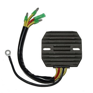

                i found this website which part # do i order i clicked on that ask a question and sent one but there closed for the weekend and no phone # to call
                Re-Designed and Improved Suzuki 550 GS550T Regulator Rectifier (years 1980, 1981 and 1982). This unit has a higher output capacity then the OE unit.  Approximately 8% more efficient than the OE regulator rectifier.  Meets or exceeds factory specifications. Several OEM numbers that apply to this part are the following:

                      I just did a test that i found to do and it was suppose to be at least 15v and it only got 12 on the regulator where would u all recommend getting a new regulator? whos the cheepest and i want good customer service not here u go bye and its the wrong one or something.
                      • Jagir
                        don't buy a new regulator yet.
                        go through the electrical system - many links in this forum. Use the search feature.
                        Start by checking and greasing every electrical ground on the bike.
